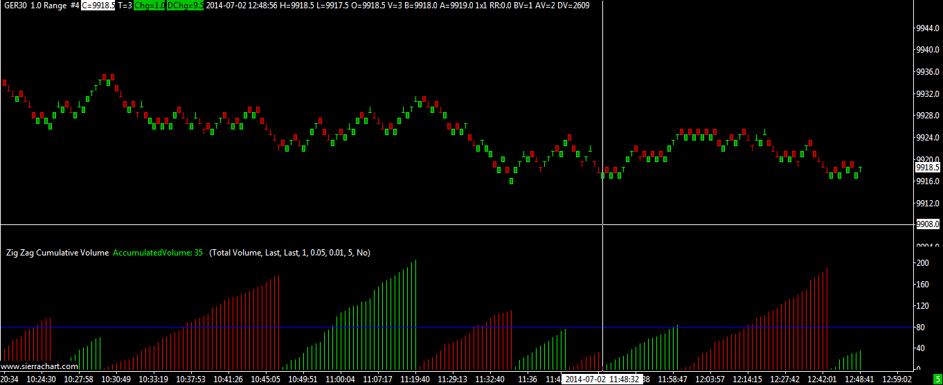

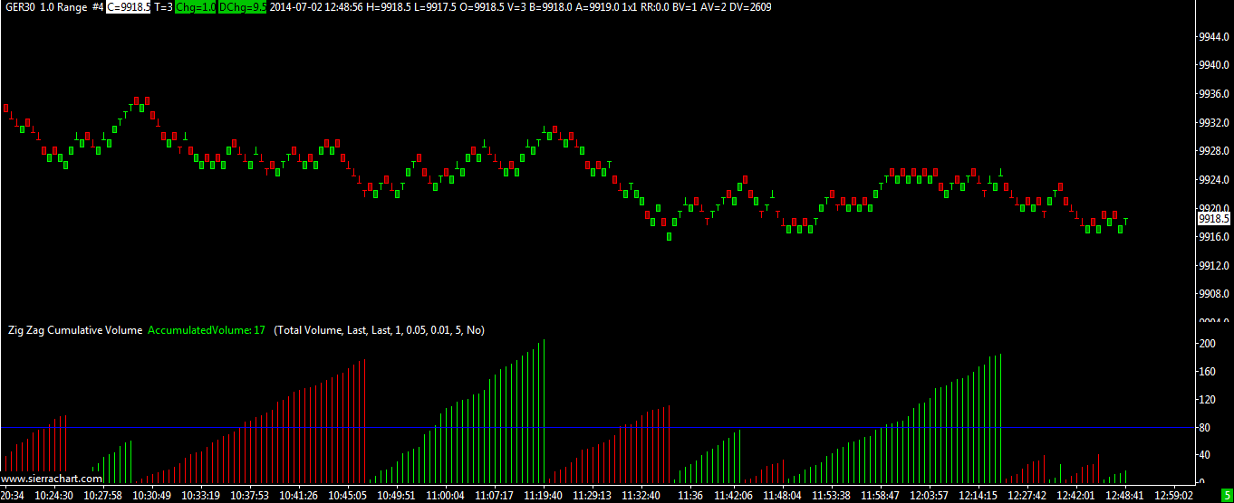

Problem of recalculation:
photo 1: before recalculation
photo 2: after recalculation
Did i make anything wrong?

[2014-07-03 04:07:59]
We need some time to look into this problem. Please allow us a few days. These kinds of issues are quite difficult to analyze.
[2014-07-06 09:22:10]
To solve this problem change Input Data High/ Low to High and Low respectively. From documentation:
Input Data for High. This Input applies to all Calculation Modes. The default is High. In the case of when the Zig Zag study is used on the main price graph and not based on any other study, this must be set to High. Otherwise, when a chart is fully recalculated, there may be different results compared to real-time updating because if you are not using a value which stays the same or goes higher when a bar is being formed but instead sometimes goes lower, then you will get an unstable result.
Input Data for Low. This Input applies to all Calculation Modes. The default is Low. In the case of when the Zig Zag study is used on the main price graph and not based on any other study, this must be set to Low. Otherwise, when a chart is fully recalculated, there may be different results compared to real-time updating because if you are not using a value which stays the same or goes lower when a bar is being formed but instead sometimes goes higher, then you will get an unstable result.
