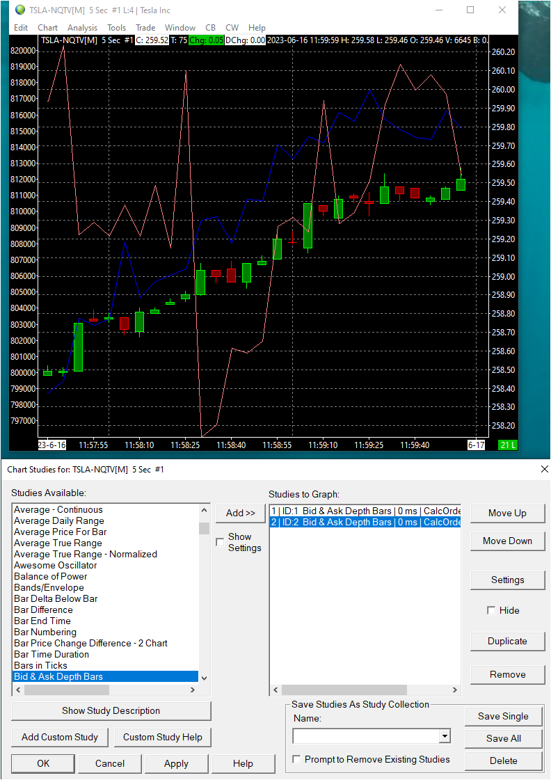

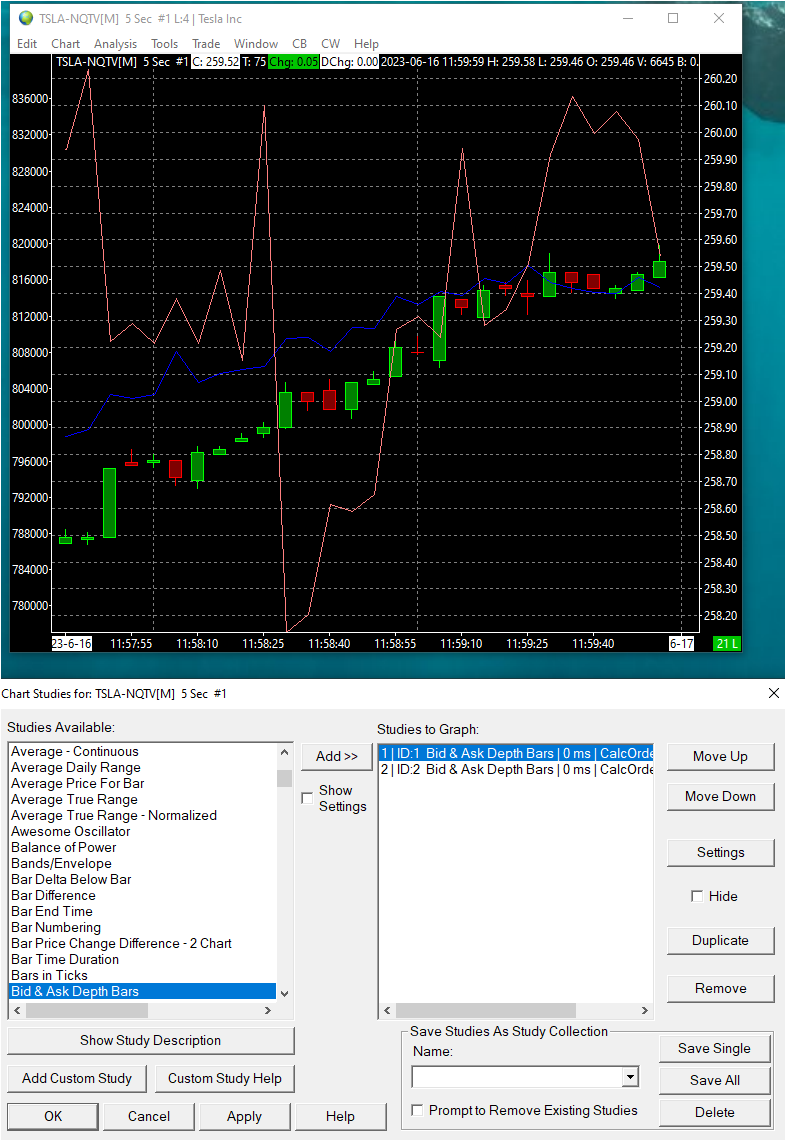

i took
ID1 :"bid&ask depth bars" study and i display the sum bid side (as line)
and
ID2 :"bid&ask depth bars" study and i display the sum ask side (as line)
i made ID1 in the scale tab "use in left side scale"
and
ID2 in the scale tab "use in left side scale"
only ID1 responded to left scale.
how can i make also ID2 responded to left scale (i need that ID1 and ID2 will be connect to left scale)
regards
[2023-06-19 11:08:17]
Sierra_Chart Engineering - Posts: 25005
We do not understand what you mean by this:
[2023-06-19 12:13:27]
User278398 - Posts: 296
in those studies, in the scale tab i choose "use left side scale". (id1 blue line,id2 pink line)
pic1 before change left scale
pic2 after
id2 not responding to left scale(it respond only to the right scale)
regards.

[2023-06-20 13:43:59]
What you want to do is not supported since the scales for those studies would have to be set to Independent.
This is not supported and never will be.
