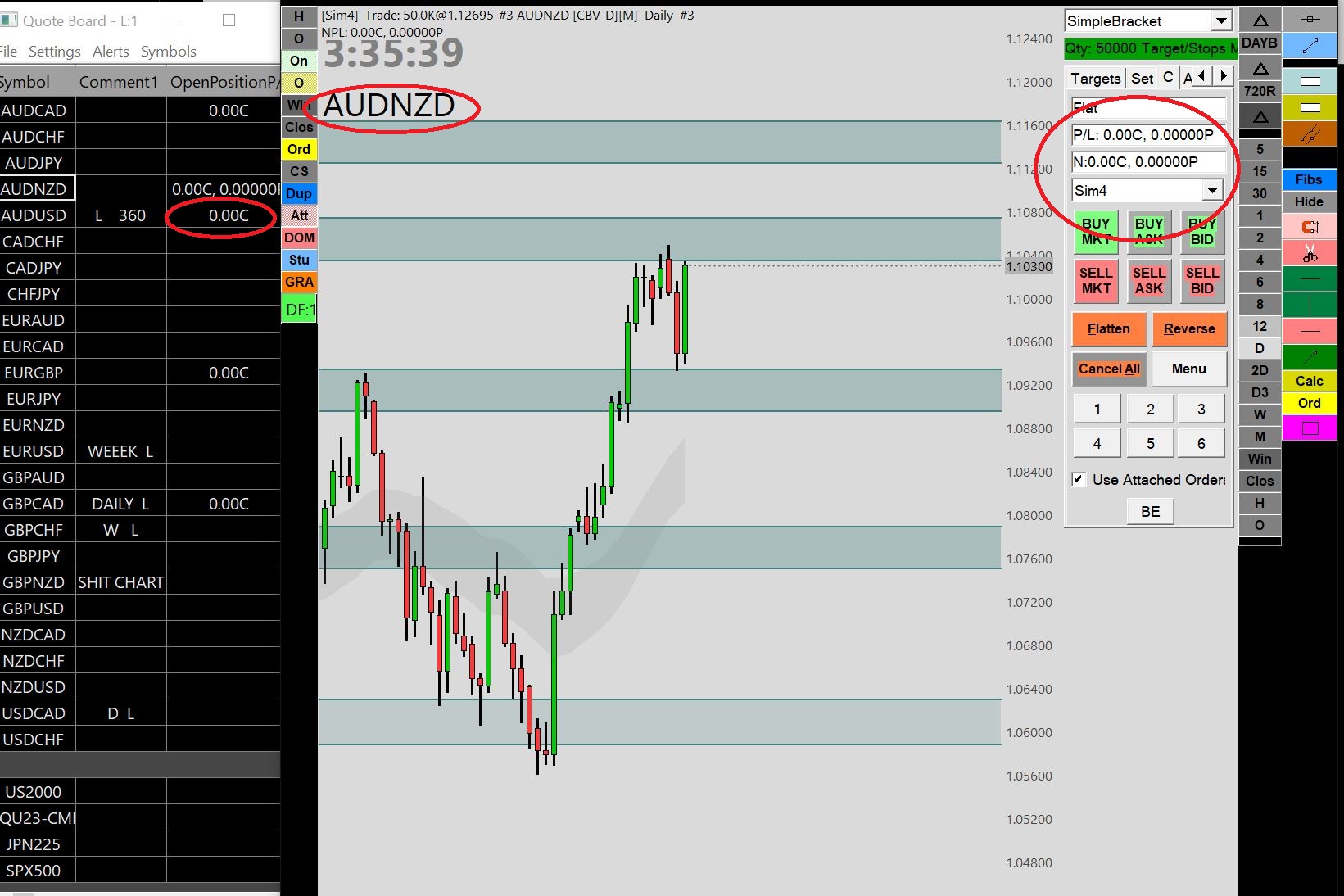

I have a question regarding the Quote Board, I set the field OpenPositionP/L to be able to see the SIM open position P/L.
The thing is most of the time it only shows the P/L when I press on the Synbol on the Quote Board and if the symbol is not selected it does not show it.
Are there any settings that would affect or not show the P/L of most of the symbols I have?
Please let me know,

We are not able to reproduce this. Please give us a screenshot showing the chart and the Quote Board where the chart shows the Open Position Line with the Profit/Loss on it so we can compare.

User871209 - Posts: 99
Thanks for the reply,
Attached are two pictures, one shows when AUDUSD in the quote board is not selected the PL is not shown, and the second picture when it is selected then it shows the PL.
I have other positions open and it is the same issue they don't appear to show.
Please let me know,
Regards,
imageAUDUSD SELECTED IN QUOTE BOARD.JPG / V - Attached On 2023-06-15 07:56:00 UTC - Size: 327.94 KB - 177 views
imageAUDUSD WITHOUT BEING SELECTED.JPG / V - Attached On 2023-06-15 07:56:08 UTC - Size: 307.8 KB - 160 views

Sierra_Chart Engineering - Posts: 25005
This would make sense when using Trade Simulation Mode since the Position data is held within the chart itself and if the chart is not set to that symbol the position data will not exist.
