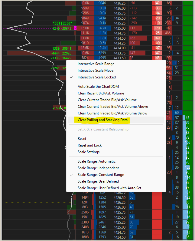

[2023-06-20 20:21:24]
SavantTrader - Posts: 112
Dear Support:
There is indeed a context menu command named "Clear Pulling and Stacking Data" (see attached), and it does indeed clear the data.
Can you please simply expose this already existing option via ACSIL, perhaps in this manner:
sc.ClearPullingStackingData();
Thank You.
Date Time Of Last Edit: 2023-06-20 20:22:41
imageCapture.png / V - Attached On 2023-06-20 20:21:18 UTC - Size: 90.11 KB - 607 views
[2023-06-21 13:54:09]
Ok we see. We forgot about that.
Yes we can add that ACSIL function.
