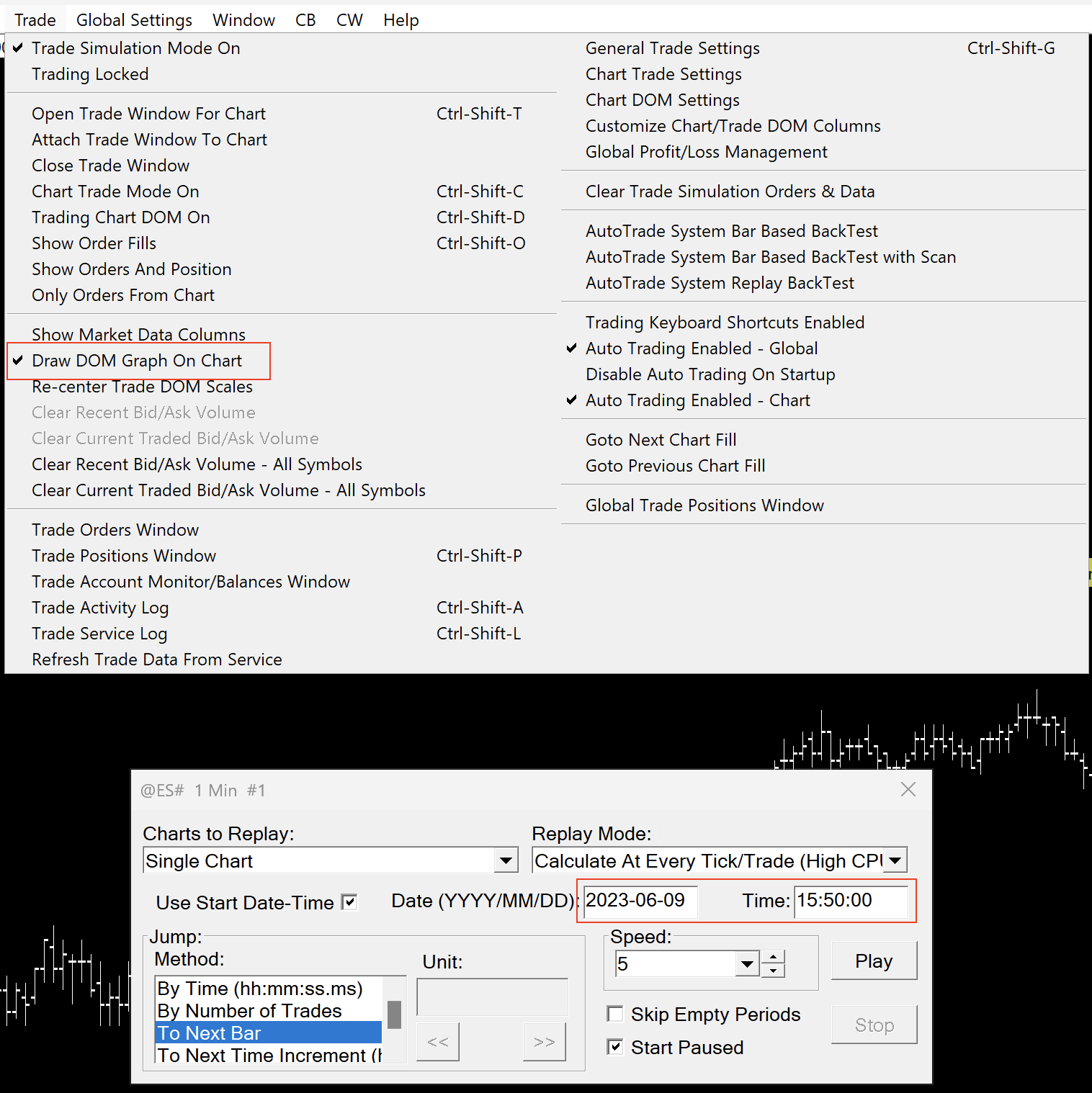

[2023-06-14 10:21:44]
rinofarina - Posts: 10
Thanks for confirming, John. I really appreciate it.
So, I went back and looked at the chart replay for the contract rollover, which occurred over the weekend 6/9-6/11. There appears to be something wrong with how the data is being processed. I've added "Trade >> Draw DOM Graph on Chart". You should notice during replay that the DOM and depth bars study appear to work properly. But then, when replay resumes on that Sunday, when the rollover data comes in, something goes wrong. You'll see the DOM is displaying data, but it appears corrupted or improperly handled by Sierra Chart.
Since I can't look at the raw depth data, I can't say for sure whether it's the data or the code that is the culprit.
Any further thoughts?
[2023-06-14 10:23:50]
Attached image of changed settings
imageSCBADBreplay_settings.png / V - Attached On 2023-06-14 10:23:14 UTC - Size: 245.32 KB - 213 views

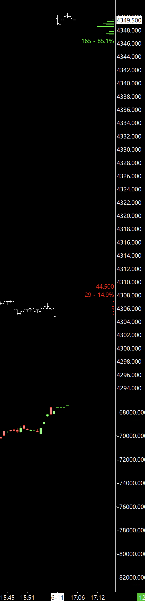

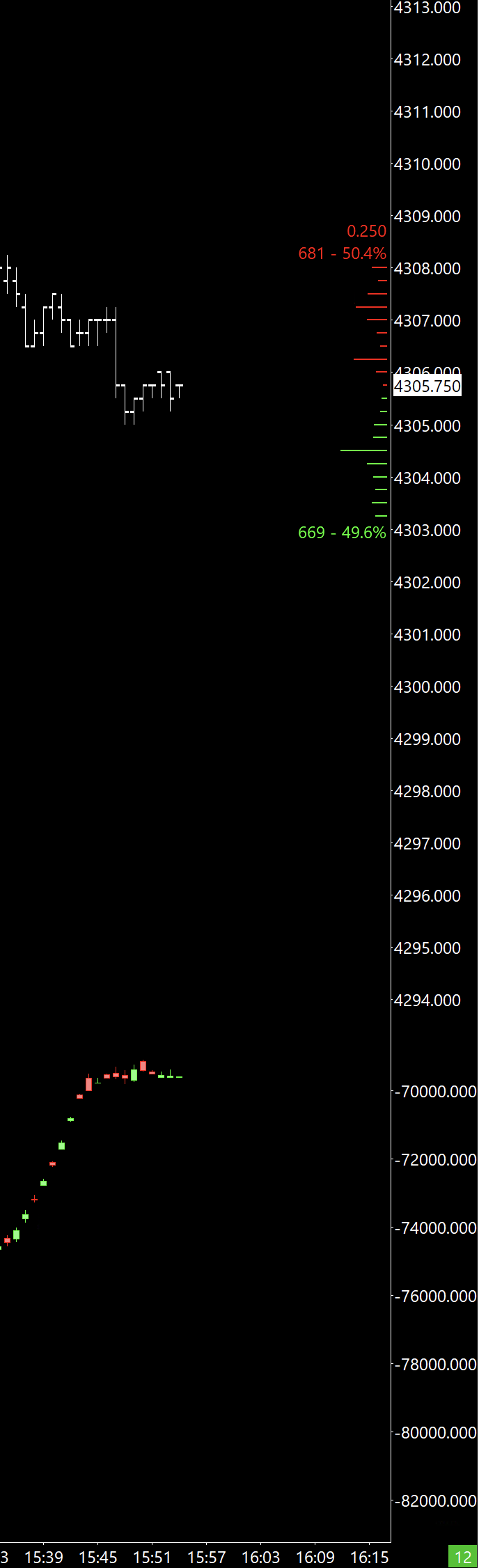

[2023-06-14 10:29:11]
Attached images of DOM before and after rollover
imageBeforeRollover.png / V - Attached On 2023-06-14 10:28:34 UTC - Size: 89.52 KB - 297 views
imageAfterRollover.png / V - Attached On 2023-06-14 10:28:42 UTC - Size: 96.13 KB - 206 views
[2023-06-14 14:43:28]
John - SC Support - Posts: 48062
The data after rollover does not look correct. Are you using a Continuous Contract setting from us? If so, you need to check with IQ Feed to see if this is what you need to do. We are not sure how IQ Feed deals with this, so you need to check with them.
