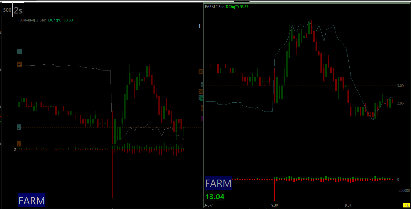

I noticed that the "Cumulative Delta Bars - Volume" shows an erroneous print when used on a certain instance
The error - At the session open there was a spike in Bid volume but the CD shows a spike up instead of down.
The CD study is the faint line on the price chart itself
I have the BidVolume vs. AskVolume below the price chart which helps to show the error.
I have enclosed a screenshot of the instance where the CD shows correctly (Left) and the one that shows the error (Right)
Settings of the study are identical.
https://www.sierrachart.com/image.php?Image=1686147135619.png
https://www.sierrachart.com/image.php?Image=168614716410.png

[2023-06-07 14:32:10]
John - SC Support - Posts: 48062
From what we see the "Cumulative Delta Bars - Volume" are inverted between the two instances. There must be something different in the setup between them.
Have you done a "Reload and Recalculate" for both charts?

funbun - Posts: 94
The Bid Volume Vs. Ask volume is not inverted - I checked
Reloaded the chart - with the same results.

[2023-06-07 15:01:52]
These charts are not at all the same, and the settings between the studies are even different. On one chart you have the Input for "Reset at the Start of Trading Day" set to "Yes" and on the other chart it is "No". Additionally, the charts have different Session Times, so even if you set this both to "Yes", the "Cumulative Delta Bars - Volume" is still going to be different.
You have to ensure that the settings are all the same in order to see the same results.
