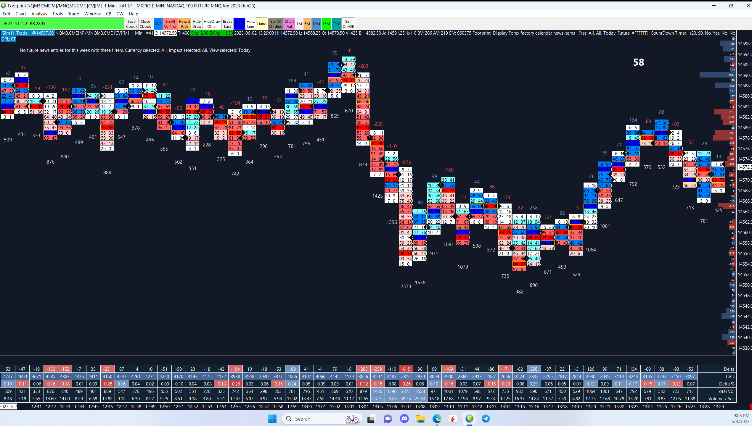

Does anyone know how to set an alert on a footprint chart? The volume are the numbers on the bottom and the delt are the numbers on the top. I would like to set an alert when the volume or delta increase by double from the previous candle.
imageScreenshot (271).png / V - Attached On 2023-06-04 01:17:36 UTC - Size: 437.42 KB - 175 views

John - SC Support - Posts: 48062
This would be done using the "Simple Alerts". The general information for these is here:
Study/Chart Alerts And Scanning
The specific items that will help you are the referencing of a Study Subgraph:
Study/Chart Alerts And Scanning: Referencing Study Subgraphs
And the section just below the Study Subgraph on Referencing a Subgraph from Another Study.
And you also need to know how to reference bars other than the current one, which is here:
Study/Chart Alerts And Scanning: Referencing Data Other Than on the Last Bar/Column In the Chart
