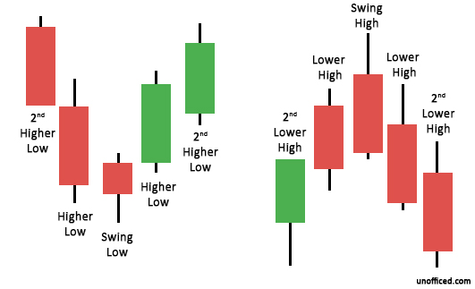

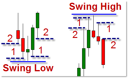

The swing high low study isn’t printing accurately. It’s giving many false signals and some no signals at all for sone reason. Is there a setting I’m missing? I would like it to print as it is in the picture attached. Seems pretty simple . What am I missing?

We really need to see an image of what you are actually seeing in your chart.
From the images, they are showing 2 bars on either side needing to be lower/higher. If you want 2 bars to test against, then be sure to set the "Length" Input to 2.

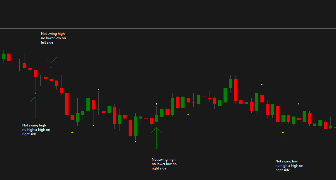

sure thing, here are a few examples

All of the Swing High and Swing Low points in the image you provided are correct for a Length of 1. Keep in mind, a Swing High is when a bar has a higher High than either the bar to the left or right (again with a length of 1), and a Swing Low is when the bar has a lower Low than the either bar immediately to the left and the right.
If you change the length to 2, then the two bars to the left and the two bars to the right have to both be lower than the High of the bar for it to be a Swing High and the same for the Swing Low only for the Low.
This also matches the images you originally provided for how you want it to work.

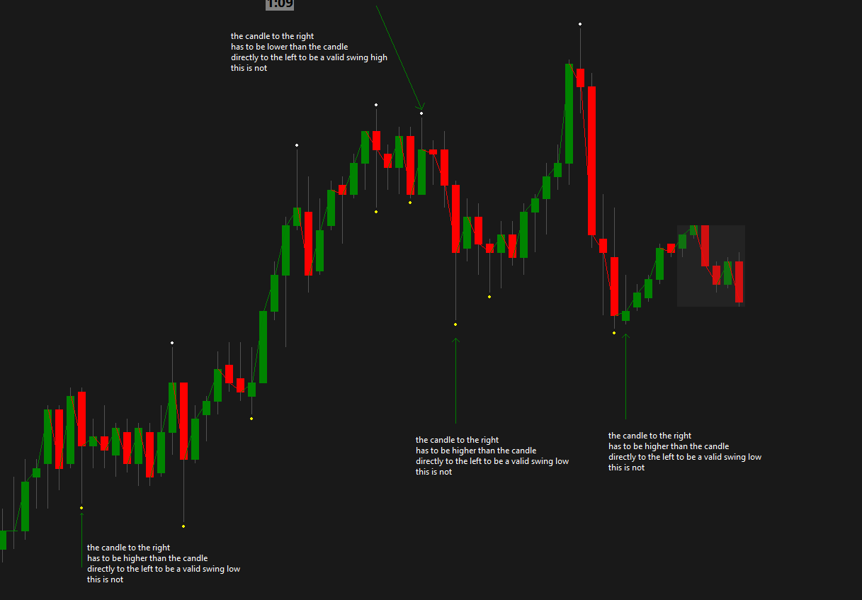

This is set to two. These examples are today on a 5 min ES micro. More false flags.

The Sierra Chart Swing High and Swing Low study does NOT work exactly as your original images indicate. As long as the High/Low of the bars on either side within the Length Input are lower/higher than the bar being tested, then the result is true. Each bar does not have to be lower than the previous one. This is also how it is stated in our docuentation.
This is not something we have to time to change at the moment, if you need the study to be such that each bar has the be lower/higher than the previous one, then that would be something you would have to change in the study itself. The source code for the study can be found in the file named Studies6.cpp which is in the ACS_Source folder under your main Sierra Chart installation folder. Refer to the following:
