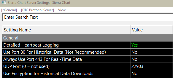

[2023-05-30 15:35:08]
User624595 - Posts: 263
Does the UDP port also need to be set different in each install?
image2023-05-30_11h33_40.png / V - Attached On 2023-05-30 15:34:51 UTC - Size: 10.92 KB - 201 views
[2023-05-30 16:03:32]
Sierra_Chart Engineering - Posts: 25005
Set the UDP port to 0. It is not needed.
