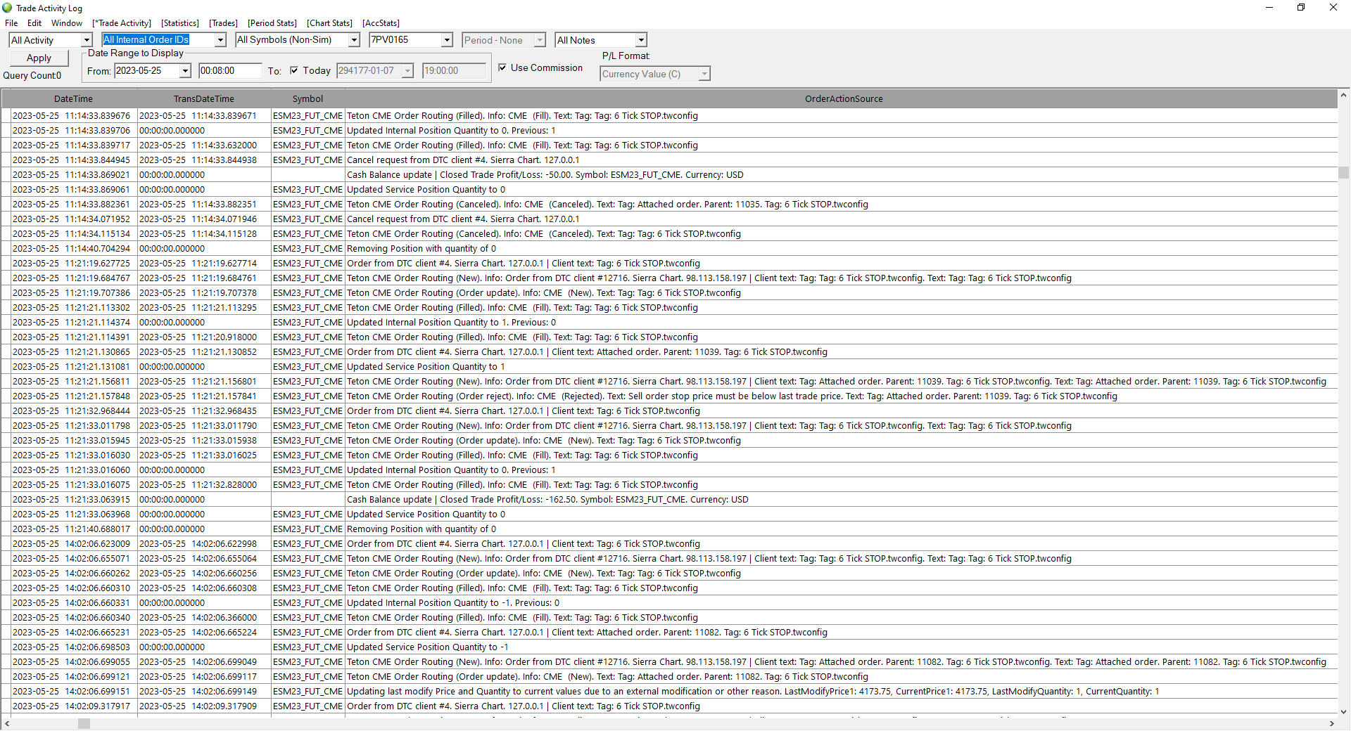

I was trading ES during cash session today and I entered a trade (1 contract) using a buy limit order at around 11:21 (see attached Trade activity log). This had an attached Stop order.
The market swept against me immediately as i got filled. My stop loss was 6 ticks. It seems as though the Stop loss order did not trigger and then seemed to cancel because now the price was below the sell stop order. So not only did I not get stopped out for 6 ticks (or slightly more with slippage) but I had an unprotected position. I then manually with mouse (used a market if touched order; i could have also hit flatten but this is what i am used to doing)-i dont believe you allow for straight market order on the mouse ? At this point I took a 13 tick loss instead of an expected 6 tick loss. I would like you to look at the trade activity log I am providing and let me know what if anything went wrong or how it could have been done differently to avoid this - other than not trading. I can also provide you a short video of the trade if that helps in any way.
Thank you
SL

At 11:21:21.202 we see the following in the OrderActionSource:
"Order update (Order reject). Info: Teton CME Order Rout"
It looks like this may be the cause of your issue, but we do not have enough information to know why the rejection occurred. Please look at the OrderActionSource for that and see if there is more information. Also, take a look at the "Trade >> Trade Service Log" and see if it gives additional information on why there was a rejection.

This may have been the problem:
Attached Orders: Market Moving Quickly Beyond Stop Price Causing It to Become Invalid

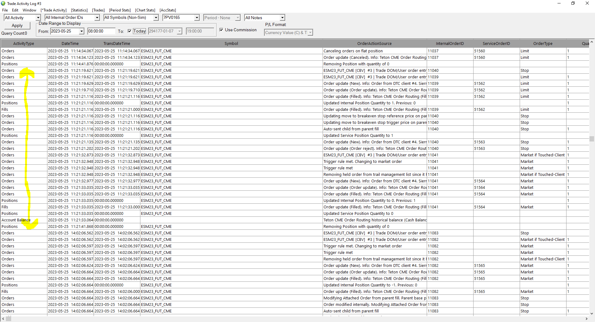

From Email:
1) I am attaching the Trade Activity Log with order action source for what
you are looking for.
2) When I try to look at the Trade Service Log it only shows the
entries for today ? Not sure if somehow these were cleared ?
3) Would you suggest using automatic replacement market order for rejected
stop attached order ? or i have heard this can be avoided by using an OCO
order because those orders are server side and attached orders are not ?
Could this also happen with tight stop on an OCO order ? I would prefer
not to use an OCO order based on my current style of trading but would be
willing to make the change if you suggest this will solve this specific
problem
imagetmp_1685120109_Follow up on order entry problem stop loss n.png / V - Attached On 2023-05-26 17:10:09 UTC - Size: 164.24 KB - 220 views
[2023-05-26 17:14:10]
1. Given that the rejection is that the "Sell stop price must be below last trade price", then the most likely scenario is what is in post #3.
2. Your "From" date is set to the 25th. You would need to adjust this date and then select the "Apply" button.
3. Yes - refer to the information in the link in post #3.
