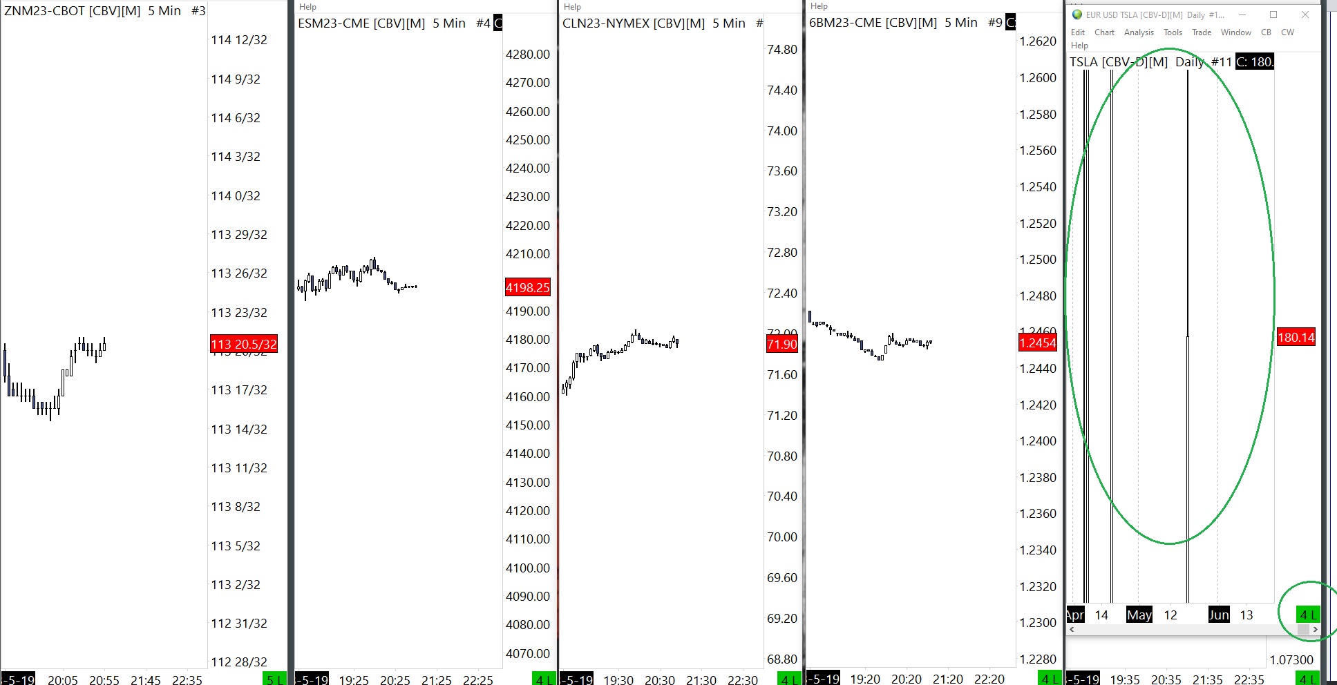

Tried to follow your link but still not able to get my duplicated chart show me candlesticks so they track the US stock market.
With that said, again I'm ready to pay to get this setup properly. I'm usually pretty tech savvy but admittingly Sierra is a learning curve to understand its nuances.
Currently need help on the following:
1) Not seeing a 'functional candlestick chart' that properly links to my duplicated DOM (depth of market) that is tracking a US stock equity (see attached graphic).

1. This looks like a scaling issue. Make sure the scales are set to "Automatic" and then reset the scales. Refer to the following links:
Chart Scale and Scale Adjusting: Opening the Scale Settings Window for the Main Price Graph
Chart Scale and Scale Adjusting: Automatic (Scale Range)
Chart Scale and Scale Adjusting: Resetting the Scale
