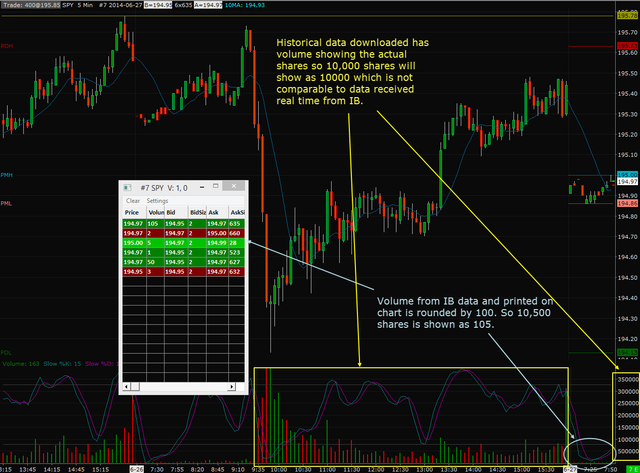

I upgraded from version 1109 to version 1152 and noticed that the volume data between historical intraday data download vs real-time data from IB is not shown correctly. As shown in the attached chart, historical intraday data downloaded shows actual volume. So for 10,000 shares traded, the volume is shown as 10000. Cumulatively, the chart scale shows volume in hundred thousand to millions. However, when I connected to IB for real-time data which was plotted on the chart in pre-market, IB's data which is plotted on the chart is rounded by 100. So for 10,000 shares, volume shows as 100. This distorts volume displayed on the chart for real-time data. Thus, it is not possible to compare the historical data downloaded from the real-time data to determine if there was an increase in volume because all real-time data will show small volume.

Anyway, for your info. I set Interactive Brokers stock data volume multiplier to 100, but since volume shows 6 to 7 digits on the scale and exceeds the window space, I was able to make the volume round by 100 by going to Chart Settings, Advanced Settings 2 and changing Volume/Open Int. Multiplier to 0.01. Now the volume scale shows volume as 10000 instead of 1000000. Everything is back to how it was in version 1109.

I just realized that what I did is just a workaround. Every time I change the stock symbol on the chart, I have to change the Volume/Open Int. Multiplier to 0.01 again in Chart Settings, Advanced Settings 2. It gets tedious since I change stock symbols several times during the trading session to stocks that are active and moving.
Update: I found that on Global Symbol Settings, I can also change the volume multiplier to .01 in the Additional Tab. However, I noticed that after setting it to .01, when I go back to it, it shows 0.0099999998 instead of .01. I know that when rounded off, this is .01 but I don't understand why it doesn't save as .01 so it doesn't have to round it off anymore. Maybe this needs to be fixed also.

We will be solving the IB US stock data volume mismatch problem. This will be solved in the next release.
We will solve this.
