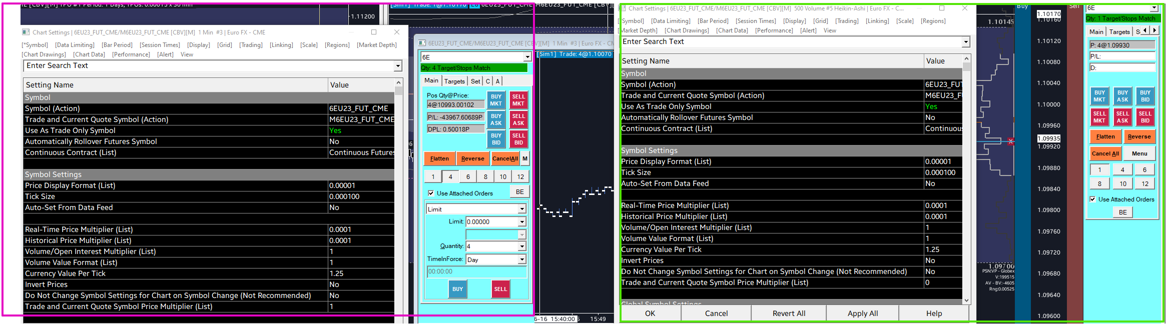

I've setup a brand new intraday chart, not using any custom symbol settings in the global symbol menu.
In attached screenshot of the chart settings, I have identical settings except for trade multiplier.
Left box is the multiplier at 1, and the price was filled at 10993.00102, right is multiplier at 0, filled at 1.09930 which is correct. This also shows on the chart.

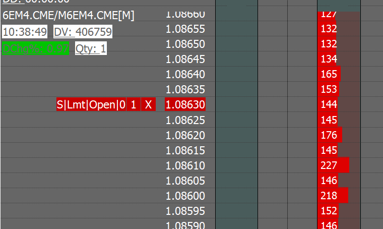

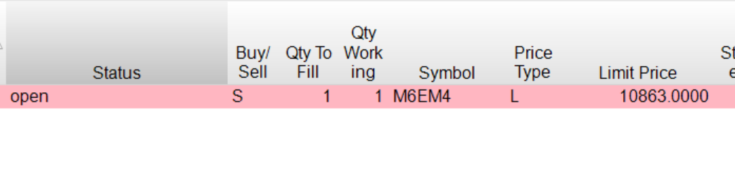

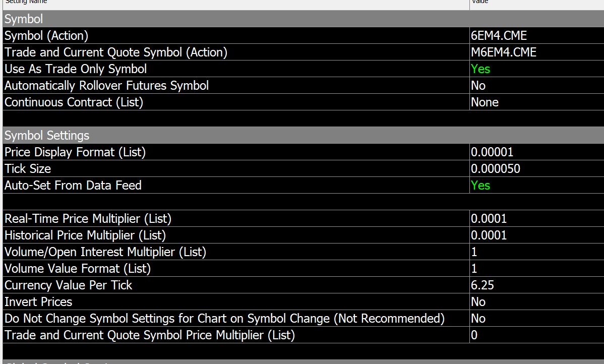

Experienced this error this morning. Some of the initial confusion could have been avoided if the poster had shown the order in R|Trader. The relevant screenshots are attached. Orders are being routed with no multiplier, it seems. The issue does not occur when trading simulation mode is turned on, only when trading live with Rithmic.
SC version is 2643 rev 50339M.
Date Time Of Last Edit: 2024-06-12 14:45:17

[2024-06-12 22:17:34]
To resolve this problem, refer to the information here:
Sierra Chart Teton Futures Order Routing: Using Trade Symbol
This also applies to Rithmic as well.
Date Time Of Last Edit: 2024-06-12 22:22:45
[2024-06-12 22:23:06]
Prior post has been updated with the correct link.
[2024-06-13 01:40:55]
joshtrader - Posts: 569
Thank you, it makes perfect sense that there would be some issues using 6E/M6E on the same chart, as the 6E tick size is half of what the M6E tick size is.
Tested and works as expected, thanks for the link!
