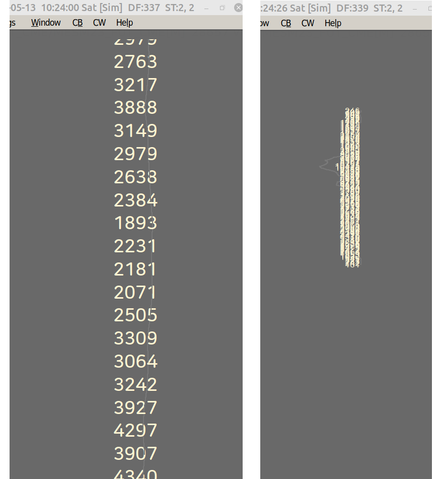

When the chart scale range is low, say 10 points, I am able to see total volume numbers in each bar on VbP, but when the scale range gets higher (100 pints +), those numbers will be smaller and stack on top of each other.
I attached image shows VbP's total volume numbers display on a 10 pt chart scale range (left), and 150 pt chart scale range (right).
All I need is just a few levels of VbP total volume numbers below and above last close.
Wonder if there is a solution to that? I am able to write a custom study that has independent scale from main graph, not sure if it is possible to set one of VbP studies that is also independent from main graph? If it possible, then I will be able to clearly display total volume numbers on a large scale range chart.

Thanks so much for your reply John! My bad, I overlooked the "Scale" button in VbP's Study Settings window, now I am able to have VbP's Scale Range settings different than the Main Graph (in Chart Settings).
Wonder if it is possible that I could change those settings/values with ACSIL? Similar to variables like: sc.BaseGraphScaleRangeType and sc.ScaleRangeType etc. (I think sc.ScaleRangeType only controls Scale Range of the study that where the variable is, not another study)
