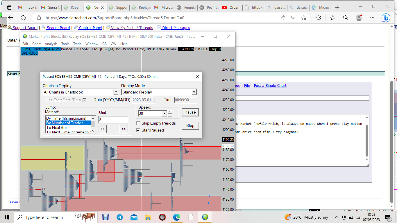

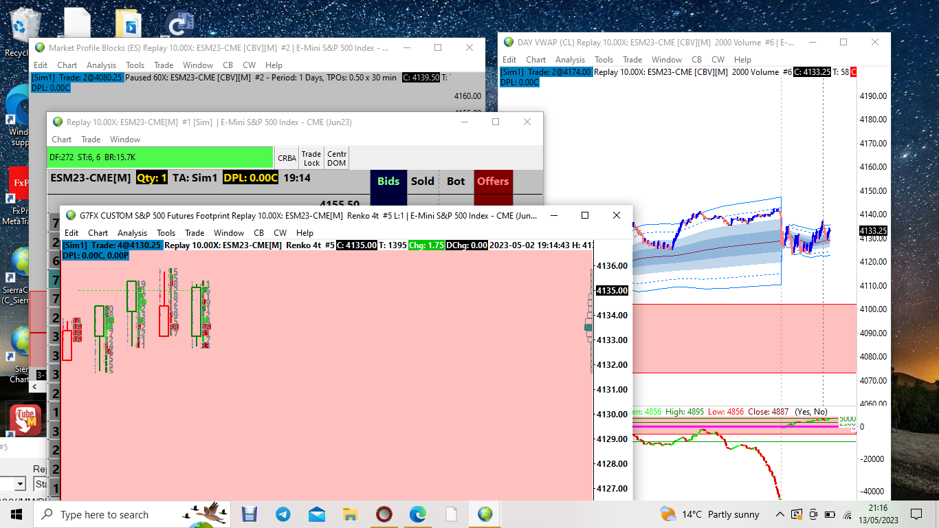

Hi
I have an issue with playback (replay)
When executing playback all my charts are in synch and playback is fine apart from my Market Profile which, is always on pause (as shown in insert) when I press play button
I've tried everything on the support page to no avail - Its just stuck on the same price each time I try playback
Any help would be appreciated
imageScreenshot (158).png / V - Attached On 2023-05-07 17:03:16 UTC - Size: 159.82 KB - 197 views

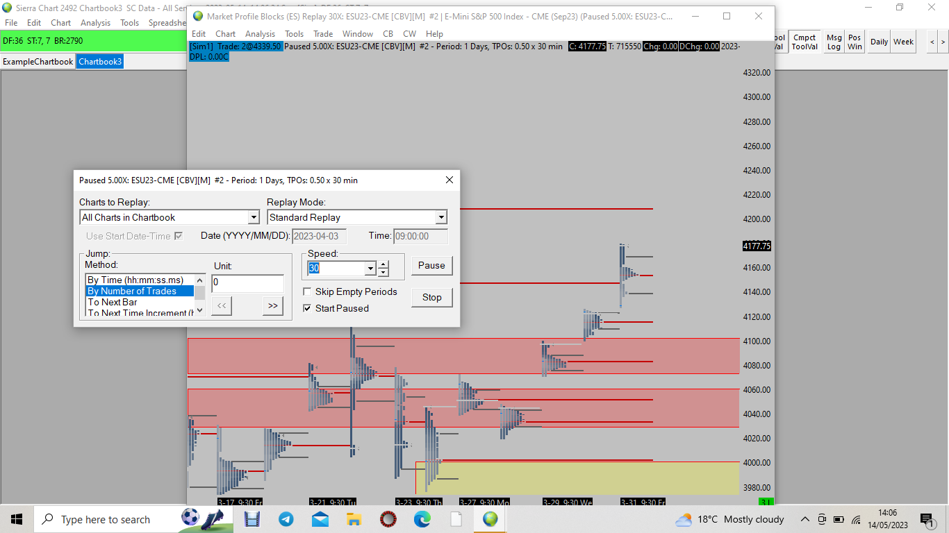

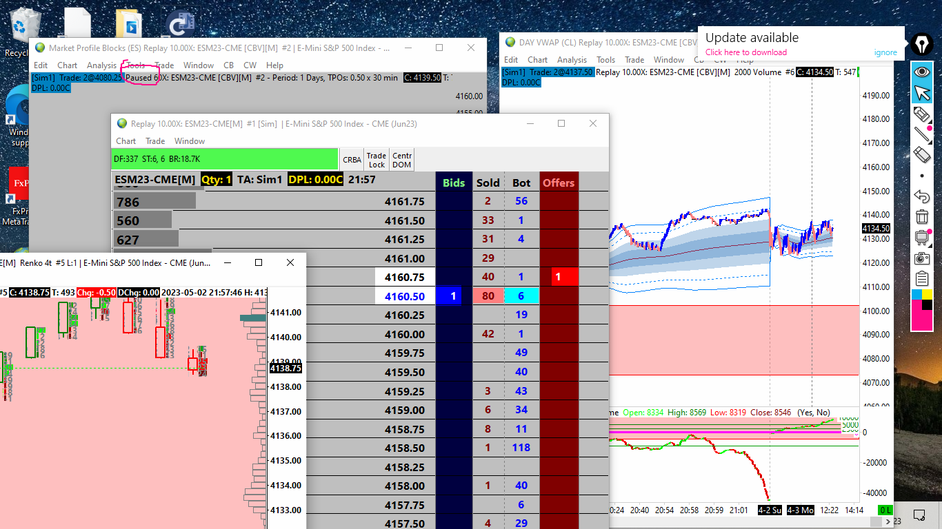

[2023-05-13 20:34:42]
Kenneth Walker - Posts: 11
Hi
Thank you for your message
I have sent you a screenshot of all 4 charts which can be seen clearly within the same chartbook
Please note top left of the screen the Market Profile is on "pause"
I have it on play the the Footprint the DOM the VWAP charts are all visible
Also, only the VWAP and the Footprint are synchronized, the DOM is nowhere near the prices on the other charts
The Market Profile is just stuck on the same price as its on pause
I hope this helps
Thanks again for your help
J Walker
imageScreenshot (169).png / V - Attached On 2023-05-13 20:17:11 UTC - Size: 468.74 KB - 181 views
imageScreenshot (170).png / V - Attached On 2023-05-13 20:33:14 UTC - Size: 392.86 KB - 178 views

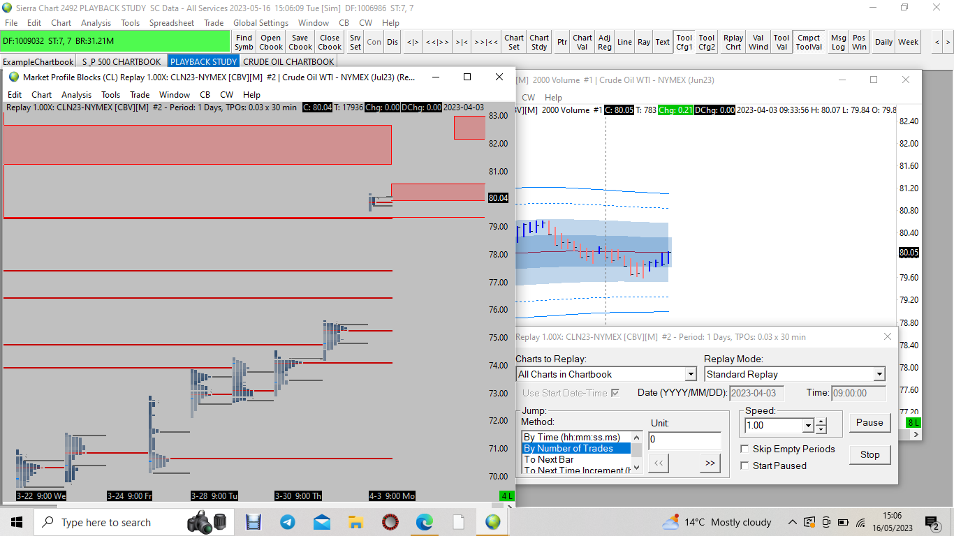

[2023-05-16 14:25:56]
Hi

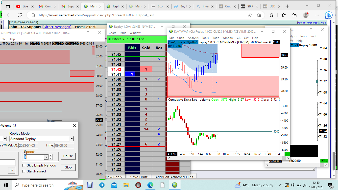

Yes I did have the option for start paused selected - I have deselected it and its working fine now. Seems that was the issue all along and it seems to be synched ok with very little latency ( please see insert)-- Thank you!
However, I still have synch issues on playback when using 4 charts (please see insert) only the Market Profile and the VWAP charts are synched, the DOM and the Footprint are nowhere near. Could this be because I am using too many charts? -All four charts work fine in real time
Thank you for your help
imageScreenshot (176).png / V - Attached On 2023-05-16 14:15:10 UTC - Size: 142.62 KB - 258 views
imageScreenshot (177).png / V - Attached On 2023-05-16 14:24:11 UTC - Size: 170.57 KB - 186 views

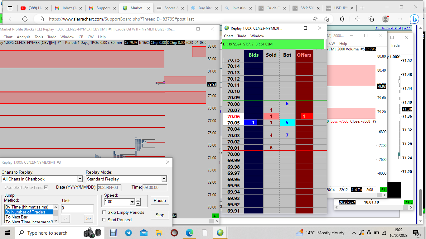

[2023-05-17 11:50:22]
Hi
Thanks for the message
I took this today and the "Skip Empty Periods" was disabled anyway
None of the charts are synchronized (as in insert) The Market Profile chart is just stuck not moving at all
Thank you
imageScreenshot (179).png / V - Attached On 2023-05-17 11:49:51 UTC - Size: 174.36 KB - 189 views
[2023-05-17 15:11:43]
Start with the TPO chart and run a replay with just that chart. Make sure it is working as expected. Then add another chart and go from there.
You might want to start the replay with the option of "Start Paused" selected. Then you wait until all the charts have loaded and then select the Play button. This ensures that you do not have a synchronization issue to start due to the loading of the charts.
