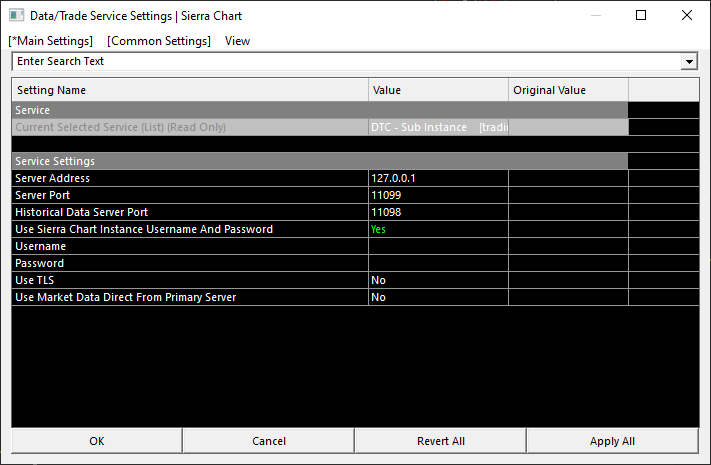

[2023-05-07 13:12:05]
nicktrader - Posts: 817
Thanks but I don't know what to set.
In the first instance I am connected with my trading service. But here in Instance 2 (pls see pic)? No idea.
Many thanks
imageInstance 2 Data Trade.png / V - Attached On 2023-05-07 13:10:44 UTC - Size: 13.73 KB - 180 views

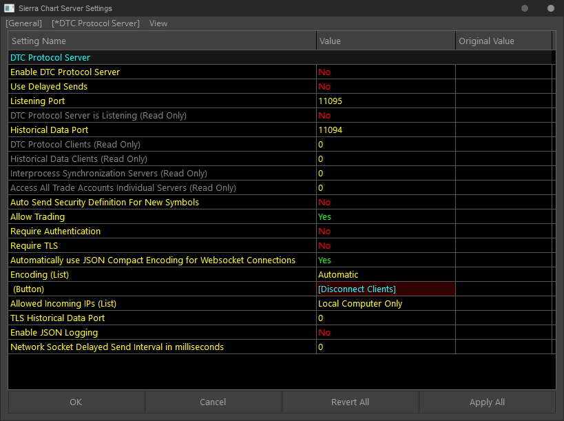

[2023-05-07 13:43:14]
Rui S - Posts: 258
Nicktrader,
That seems ok.
Make sure that you have "Listening Port" and "Historical Data Port" on "Sierra Chart Server Settings" / "DTC Protocol Server" with the same numbers.
Also, if you have more main instances than this one, make sure those figures I mention above are set to different values.
Hope that helps.
Date Time Of Last Edit: 2023-05-07 13:44:26
imageMain instance.jpg / V - Attached On 2023-05-07 13:42:30 UTC - Size: 238.67 KB - 187 views
imageInstance 2.jpg / V - Attached On 2023-05-07 13:42:55 UTC - Size: 238.83 KB - 175 views

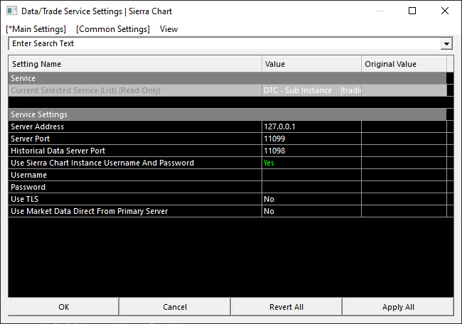

[2023-05-08 03:41:23]
Today the markets are open again and I have moved the instance 2 folder completely.
Then I opened a new second instance. But the data for service and server are the same as before (see pic).
I also tried to place a "LIVE" order in instance 2, but without success.
What can I do to trade LIVE in instance 2 as well?
imageNew Instance 2 .png / V - Attached On 2023-05-08 03:41:09 UTC - Size: 14.71 KB - 167 views
[2023-05-08 10:50:03]
Rui S - Posts: 258
nicktrader,
Given your description, I guess that you should have some setting in the main instance that is somehow causing that.
My next step would be to install a brand new main instance (not changing any settings of it) and then create a second instance from that main instance. If the problem disappears, I would go through the related Settings menus of both (old and new) main instances and would try to figure out what settings are different.
Meanwhile, you have probably already done that but you can also try and read the related information:
Using DTC Server for Data and Trading in Another Sierra Chart Instance
If none of the above sorts out your problem, I don't know what else I can recommend you except waiting for an answer from the support.
Again, good luck with that.
