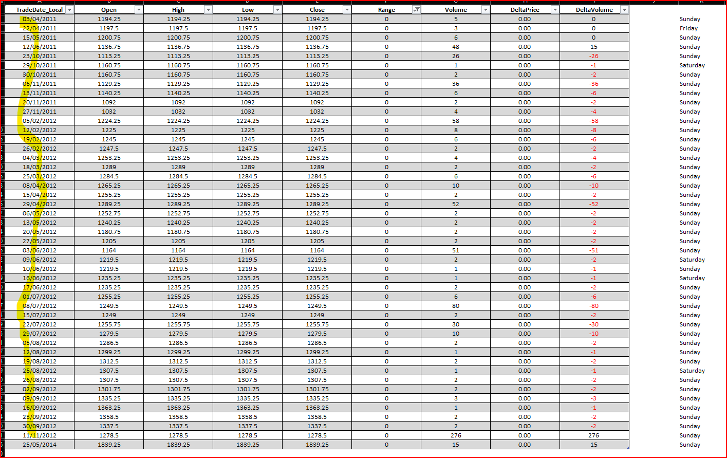

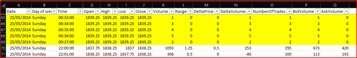

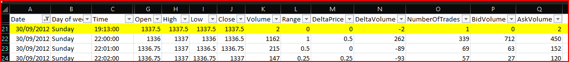

Hello, thanks. The main issue I have is there are ticks showing traded on Saturday and early Sunday (1am) UTC, which does not seem plausible.. I have attached some images for reference. What would the reason be for this?
Date Time Of Last Edit: 2023-05-01 17:06:14
imageEP_25052014_003300.png / V - Attached On 2023-05-01 17:06:00 UTC - Size: 30.7 KB - 194 views
imageEP_30092012_191300.png / V - Attached On 2023-05-01 17:06:04 UTC - Size: 22.46 KB - 224 views
imageEP_all_dates.png / V - Attached On 2023-05-01 17:06:09 UTC - Size: 124.36 KB - 230 views

That is going back a long time ago. Data that far back perhaps does have some data on Saturday and Sunday before the Sunday evening open. It would have to be exchange test data.
We really cannot help with data that far back in time. Although we should be able to filter out the Saturday data but Sunday might be difficult.
Date Time Of Last Edit: 2023-05-01 17:17:12

I understand it goes back a long time, but at what point in time can I then say the data is reliable? Is seeing exchange test data in the data expected?
[2023-05-22 10:25:06]
Sierra_Chart Engineering - Posts: 25424
This is really hard for us to answer. Maybe going back about 8 years.
