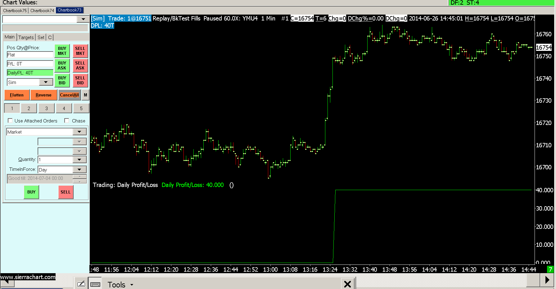

[2014-07-01 15:52:07]
amirN - Posts: 169
Please look at the attached file, trade window shows the correct number of ticks while the study shows it as currency value.
imageCapture 1.JPG / V - Attached On 2014-07-01 15:50:56 UTC - Size: 147.43 KB - 669 views
[2014-07-03 03:56:17]
We have tested for this problem again and could not duplicate it.
The documentation says this:
For the trading studies that display Profit/Loss values, the format of the Profit/Loss value is dependent upon the Chart >> Chart Settings >> Advanced Settings >> Position Profit Loss display setting. Profit/Loss formats which use - Ignore Quantity will be considered the format without the Ignore Quantity. Therefore, if you select Ticks - Ignore Quantity, it will be interpreted as Ticks.
So you need to be aware that the Ignore Quantity does not apply and what you are actually seeing would be Ticks. Does this make sense? We cannot verify this because we do not know what the order fills are.

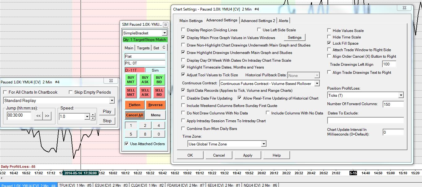

[2014-07-03 07:33:48]
amirN - Posts: 169
This is very strange, I must be doing something wrong.
I have just done a simulation with YM and lost 11t which as can be seen in the attached image (trade window) however, the daily profit/loss study shows -55 ($5/t for YM). In the position profit/loss display setting I used Ticks.
I have also done the same with Russel and the same things happens i.e a 10t loss => -100 ($10/t).
I am using SC version 1154. Version 1115 was working for me, if this problem cannot be resolved, I will be forced to downgrade to that version.
Kind regards
imageCapture.JPG / V - Attached On 2014-07-03 07:26:28 UTC - Size: 196.51 KB - 610 views
[2014-07-03 08:00:13]
Maybe you are looking at a different study.
We are testing the study named "Trading: Daily Profit/Loss". What is the study you are using?
Also, refer to this help topic:
https://www.sierrachart.com/index.php?page=doc/helpdetails77.html
We just did a test again and we see absolutely no problem. Refer to this image:
http://www.sierrachart.com/image.php?l=1404374521666.png
We do not believe there is anything wrong. There must be some other explanation.
Date Time Of Last Edit: 2014-07-03 08:02:29
[2014-07-03 08:02:12]
This is the correct image we meant to show:

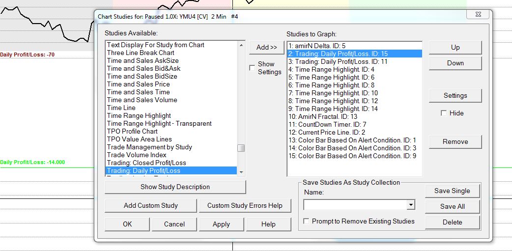

[2014-07-03 08:21:22]
amirN - Posts: 169
Now I have applied another indicator "Trading: Daily Profit/Loss" to my chart and the first one shows the number of ticks and the other one the currency value!
Please see attached. The one in Green is the one I have just added showing -14t loss and the other one is showing -14*5= -70 $ loss.
imageCapture.JPG / V - Attached On 2014-07-03 08:17:25 UTC - Size: 120.68 KB - 649 views
[2014-07-03 08:23:45]
Actually we now recognize the problem. This does make sense. There is an new internal variable which has to be set which causes the study to do the proper profit/loss calculation.
An existing study does not have this variable set.
[2014-07-03 13:01:12]
amirN - Posts: 169
So the suggestion is to to delete and re-apply the study from all my charts.
Did you come up with any solution regarding this comment?
I have already have two instances of Sierra chart to deal with two different brokers. Your suggested solution requires four instances of SC. Is thre any variable I could use to do it in ASCIL?
[2014-07-03 16:09:18]
Yes. This will solve the problem.
