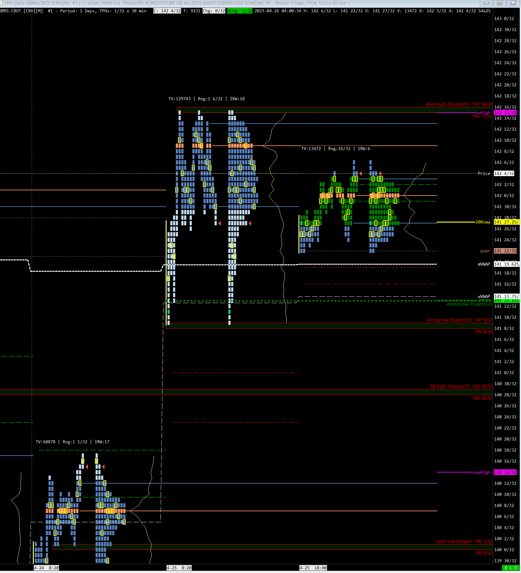

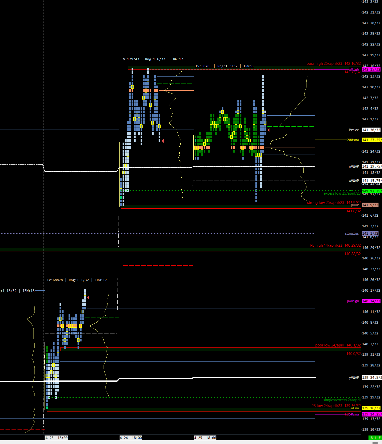

Hello guys,
Until before the open of the treasury markets (08:20 ET) my charts (UBM3.CBOT) was displaying just fine, however now I see a wrong profile for yesterday 25th of April, and the Overnight profile is merged with the RTH one, even though I have the settings to only show the last Overnight profile, and start a new one when RTH begins. Im attaching the current view, how it was looking this morning, and some of the settings.
I am running version 2492. I tried restarting Sierra, same result after a new start was performed. Also the Delete and Download Data, same result.
As you can see comparing the image of this morning, the TPO from yesterday doesnt have a poor low, however the one I see now has a poor low. So it is not only that the Overnight and the current RTH are together, but also the problem with yesterday' data.
What can I try out?
Thank you!

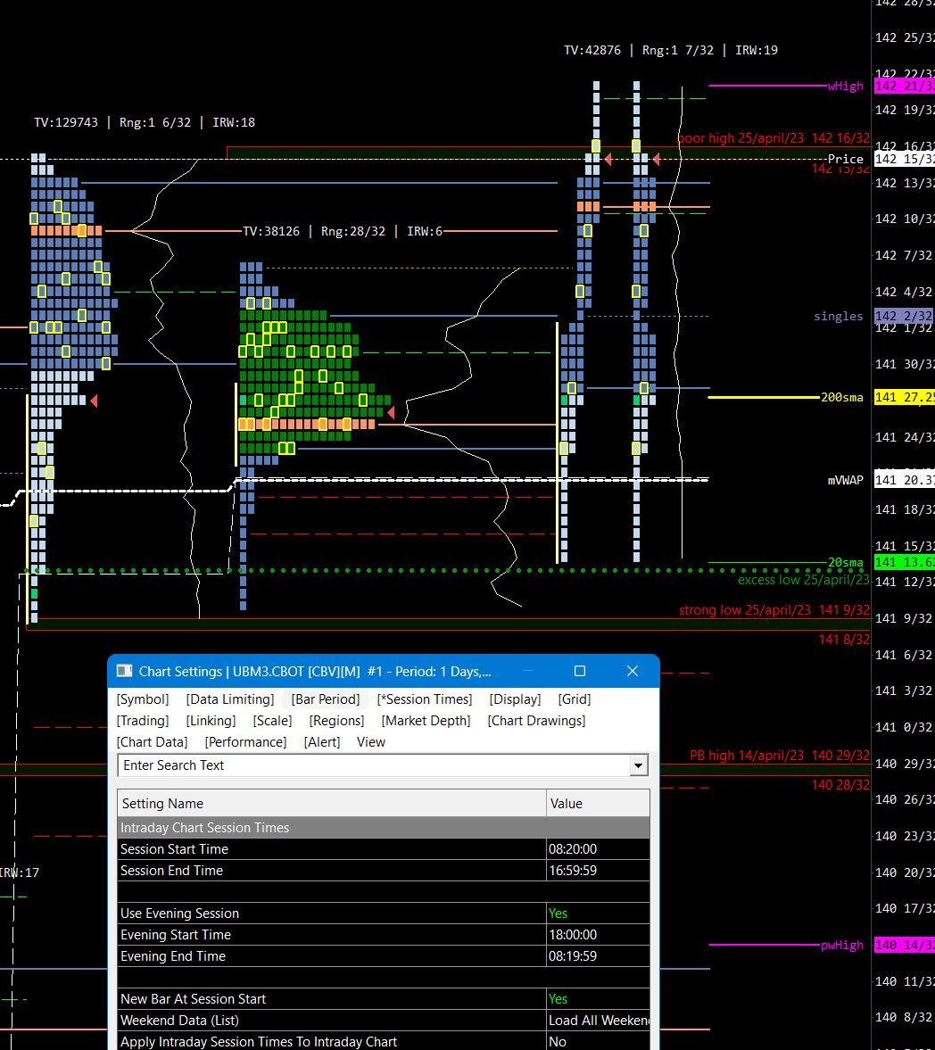

[2023-04-26 14:34:48]
If you had the system running when the change in the trading day occurred, then there is nothing that forces the previous day profile to remove the Evening Session, so it would still be showing it, even though the new day is also showing it.
Since you are not wanting to show the Evening session except with the current day, you would need to do an "Edit >> Reload and Recalculate" on the chart when the new trading day starts.
[2023-04-26 14:51:04]
Tofer - Posts: 38
hi! I checked what you said about "Edit >> Reload and Recalculate" but that didnt work. However, I went to the chart Settings, and I realized that the Session Times was incorrect, I have no idea why, but the Session Start TIme was set to 18:00, instead of 08:20. I changed that and now the TPOs look good. I am 100% sure I did not change anything there today.
Just attaching the screenshot of the TPOs with the correct Session time.
Is there any log that I could check to see when that change was made?
Thank you!

[2023-04-26 15:12:51]
There is no information on when settings or other items are changed. So there is no way to know what caused the Session Times to change.

Tofer - Posts: 38
Hello, I think I found the issue, however it is still unclear why this happened. I copied a chart from another ChartBook, and that chart had the Session times defined "wrong", so those setings somehow were copied to the TPO chart, only to that one though, my execution chart didnt receive any change.
[2023-04-27 14:28:29]
You might want to check the "Linking" to see if perhaps that was set such that the one chart updated the Session Times. Refer to the following:
Chart Settings: Linking
