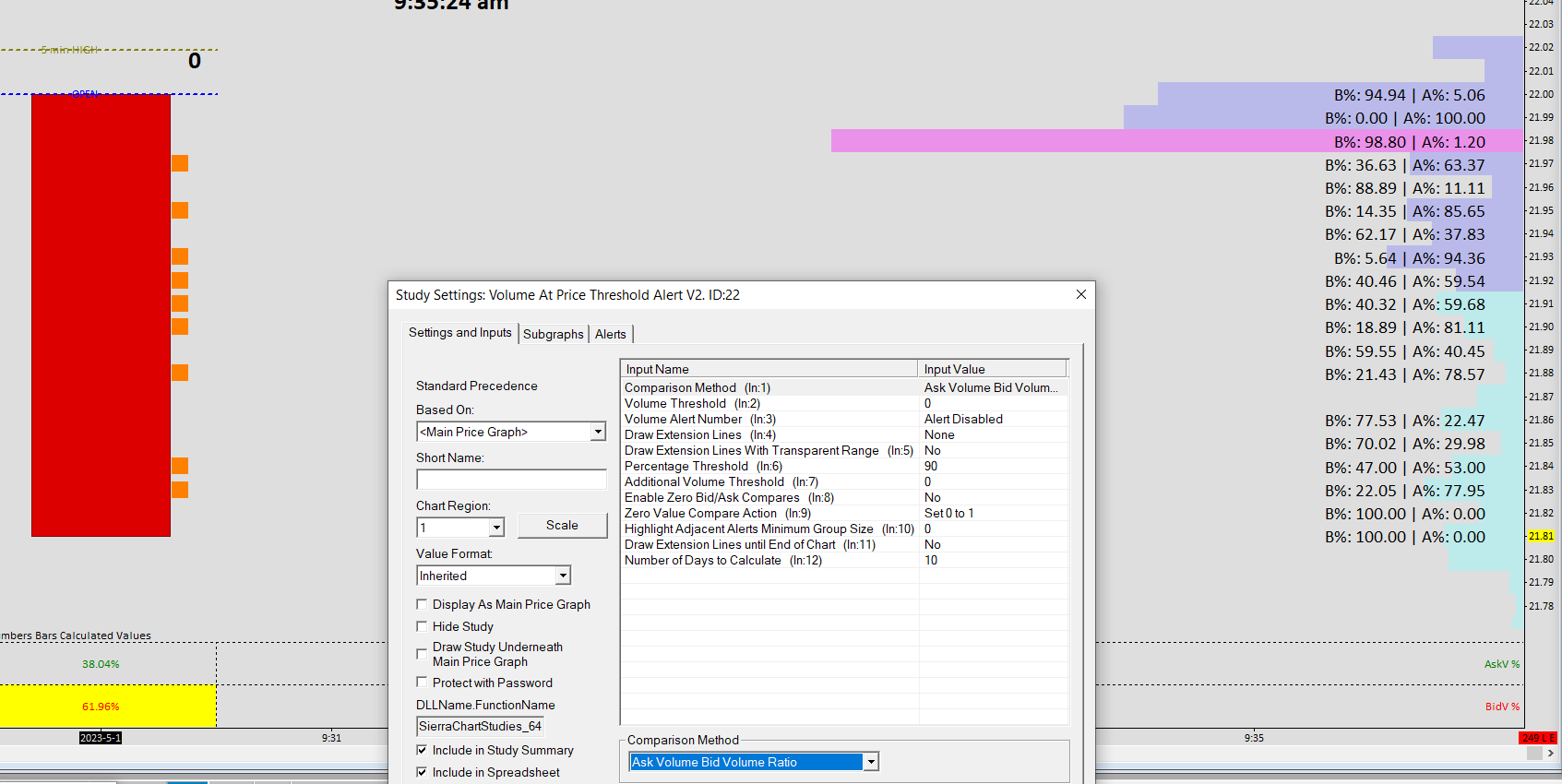

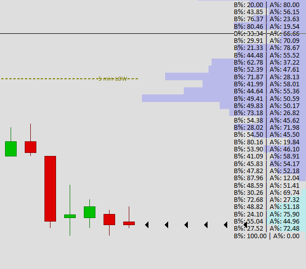

I have a vol by price study right-aligned and I have hidden the actual volume bars and just display volume numbers in bars (bid % and ask%). Is there a way to highlight the background if percentage is over 70% on bid side? Not sure if that's an option within this study?
imagehighlight numbers.png / V - Attached On 2023-04-24 23:24:17 UTC - Size: 51.84 KB - 266 views

I can't figure out how to display the alert correctly? If I set ask % above 90 to be highlighted you can see it's highlighting more prices than that? Can you help?
imagevbp threshold.png / V - Attached On 2023-05-02 00:18:43 UTC - Size: 139.43 KB - 252 views
[2023-05-02 16:31:11]
Sorry, we did not realize that there were not exact matches to the calculations when we told you to use the Volume at Price Threshold Alert V2. The Volume at Price Threshold Alert V2 has a Ratio of Ask Volume to Bid Volume (so just the two divided by each other), but the Volume by Price does not have this option, it uses a percentage based on the total volume at that price, so for the Ask percent it is: Ask/(Bid+Ask).
If you really are wanting to use the Volume by Price calculation method, then there is an option, but you have to create a lengthy Alert condition, and depending on how many price levels you are checking, you may not be able to do it.
Let us know and we will point you in the direction.
