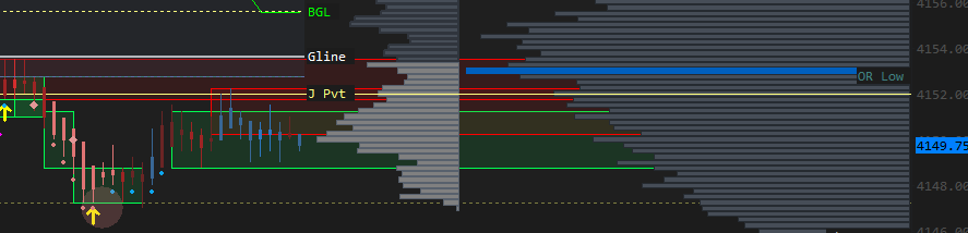

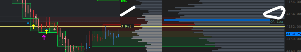

I moved my weekly MGI labels to show on "right edge". But they're hidden under the weekly volume profile now. Is there a "bring to front" button / setting to get those labels to move forward so they aren't hidden by the weekly volume profile? See attached picture... the white line I marked should be labeled "Gline" and when I have it to right edge, it's covered up. I have a picture with the setting at "Right Edge" and one at "Right".

It sounds like this is a drawing. If it is a drawing, then you would need to change the following setting (and the one after it) to have the drawings drawn above the graphs:
Chart Settings: Draw Highlight Drawings Underneath Main Graph and Studies (Chart >> Chart Settings >> Chart Drawings menu)
[2023-04-24 18:53:11]
User276813 - Posts: 68
It's an Orderflow labs study, weekly MGI. That didn't work to have that particular item not be hidden behind the volume profile.
[2023-04-24 20:16:46]
We do not know then. They could be using a subgraph or a drawing. You would have to ask them about this. If they are creating a drawing, then they may have forced it to the back, so it is something you would have to ask them about.
[2023-04-24 20:43:08]
User719512 - Posts: 541
Sierra draws studies and Subgraphs in the order they are listed in Study Settings. If the MGI study is after VBP, then its Subgraphs should draw on top of the VBP.
[2023-04-24 20:56:48]
User 719512, thanks! That did it.
