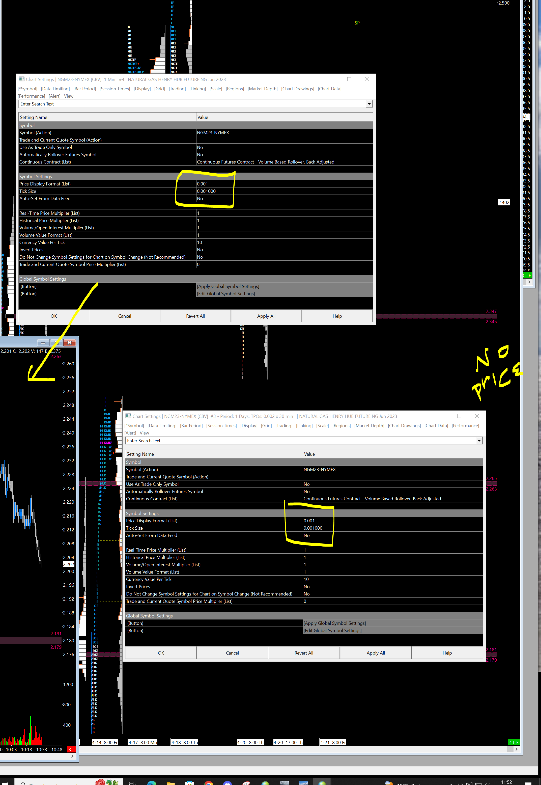

This is natty gas. I can't get the scale to work on the right side for the market profile chart. You see I have the exact same tick settings on both charts. The 1 min chart is fine, but nothing I do to MP will make it scale right. I have tried every single option when I right click in the grid area. Nothing they all look like this-wide huge gap with no value.

Do not change the Price Display Format or the Tick Size. Those will not do anything for the scale showing up.
The main thing we can think of is the Scale Increment settings. Check this in the scale Window for the chart and see if it is set to anything other than 0. If it is, then change it back to 0 (zero) and select OK to close the window. Let us know if this resolves the issue.

GENIUS YES THAT WAS IT. HAD A COUPLE OF NEW CHARTS W THAT ISSUE. ALL FIXED. YAY
