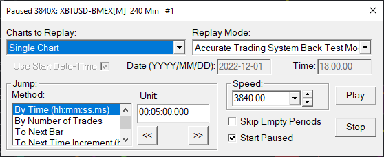

As you can see in the image, the furthest date from which I try to do the back test is 2022-12-01, it was a writing error, the previous message.
The central issue is that I need to know how to run a BT for a period greater than 30 days, since when I try to do it, the graph only starts from 30 days ago, despite the fact that the age I request is greater.

imageBT.png / V - Attached On 2023-04-24 19:46:13 UTC - Size: 13.73 KB - 260 views
[2023-04-24 20:21:08]
One of the things we see is that you have the option for "Start Paused" selected. Therefore, you would have to select "Play" twice to actually get things going.
But otherwise, as long as you have data that goes back to December 1, 2022 in the chart, then there should not be an issue.
