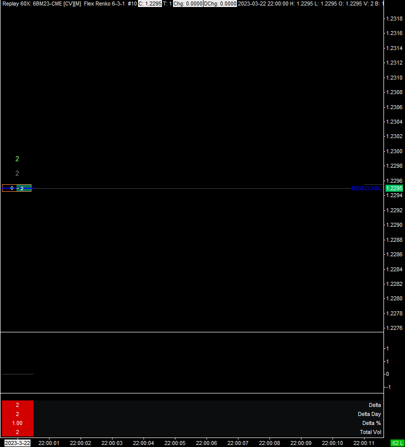

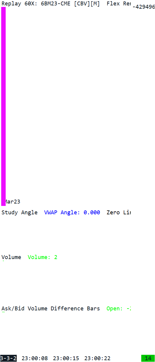

User228314 - Posts: 3
These are some of my charts as you can see no data loads for them as for my market profile charts they just go back to a date from 2022 even though it is not the date I had imputed to replay to.
https://www.sierrachart.com/image.php?Image=1682171750733.png
https://www.sierrachart.com/image.php?Image=168217240671.png

The first thing to keep in mind is that the replay is only going to work for the bars that are present in the chart. You can not start a replay earlier than the bars that are present. If you want to go back further, then you will first need to load the data going back as far as you want the replay, then you can start the replay from that point.
With this in mind, let us know if you still have an issue, and if so how far back you have the data in your chart and when you are starting the replay.
