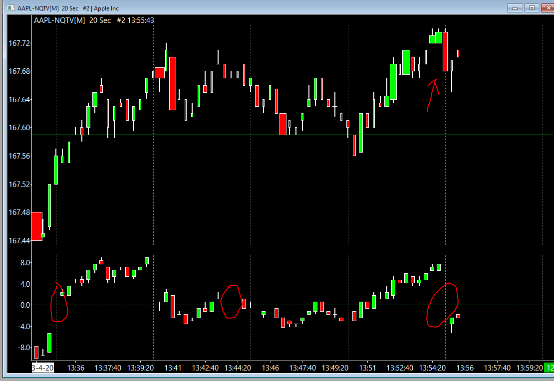

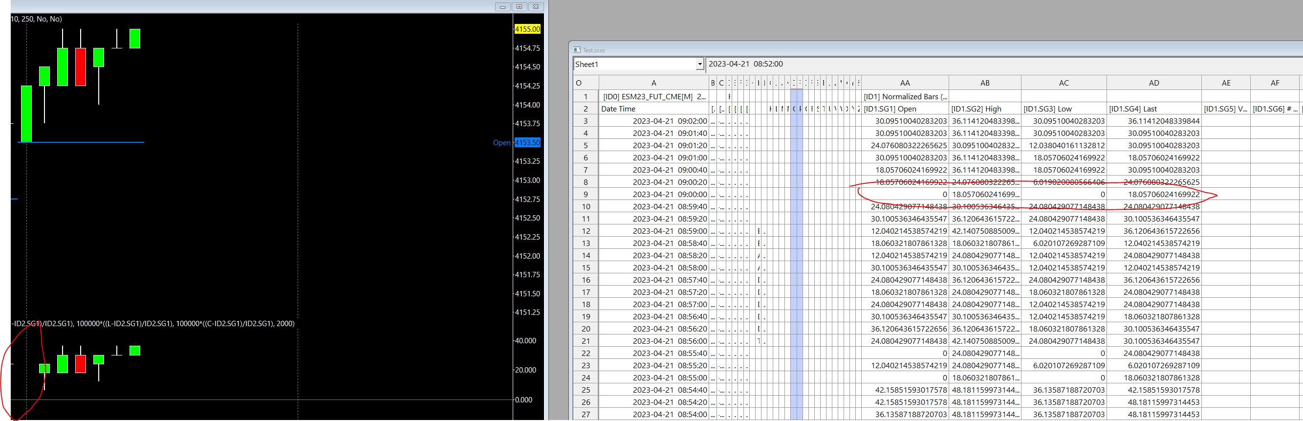

I want to place stocks side by side and see a relative strength between them and which way they're moving from this 5m bar's open. I coded up a normalized bar that looks pretty good HOWEVER many bars just do NOT show up.
I've attached screenshot and a ONE chart test workspace. Seems 10% of the bars don't show up for some odd reason.

[2023-04-20 18:00:23]
TopGunTrader - Posts: 313
I took equivolume bars off and put regular candle and same issue.
Thank you for the response however I'm very confused! The top chart is plotting movement and volume, I doubt there is a second that Apple doesn't trade at all and certainly not for 20 seconds.
The top candle is printing like normal and I've verified its accuracy with another data feed/trading platform.
But taking that data and using spreadsheet bars below there are some bars not showing up. I can't see how this isn't a bug or some setting I don't have checked. All I'm doing is normalizing the bars so ANY movement on top WILL cause movement below. It's not just wrong NOTHING shows up on some bars even for BIG moves on stock candle above.

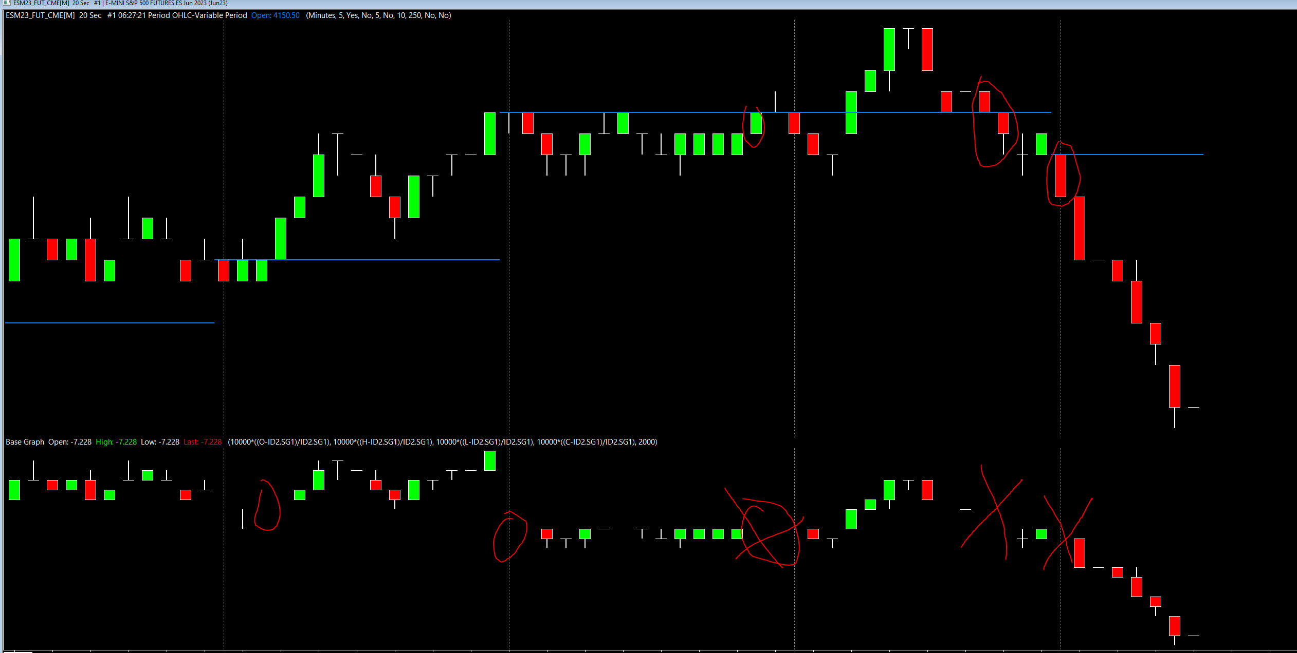

Can you please run this chart and see for yourself, something is wrong and the code is as simple as it can get.
High of bar is 10000*((H-5m OP)/5mOP) I didn't want fractions below so kept adding a 0 till I got whole numbers for scale.

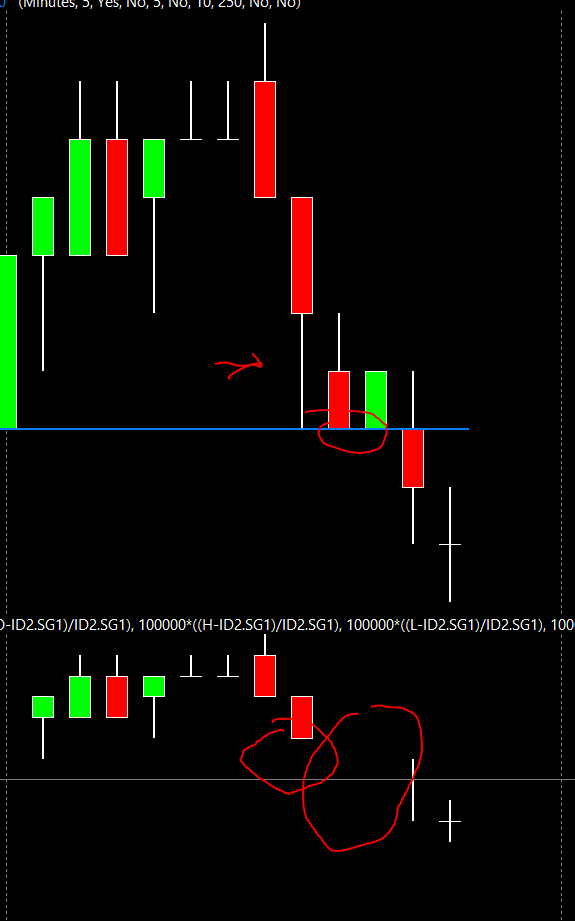

Here's pic of the S&P futures and notice when I add this study on PAST data there are many bars NOT showing on the bottom. I really like this study concept and see it having real benefit to my trading but can't use it till it works perfectly and its missing many bars. Please help me figure out what I did wrong or if its a bug try to fix it.

I left it running and live bars aren't showing up and at other times not drawing the high/low correctly all t his does is normalize price the candles should look identical.

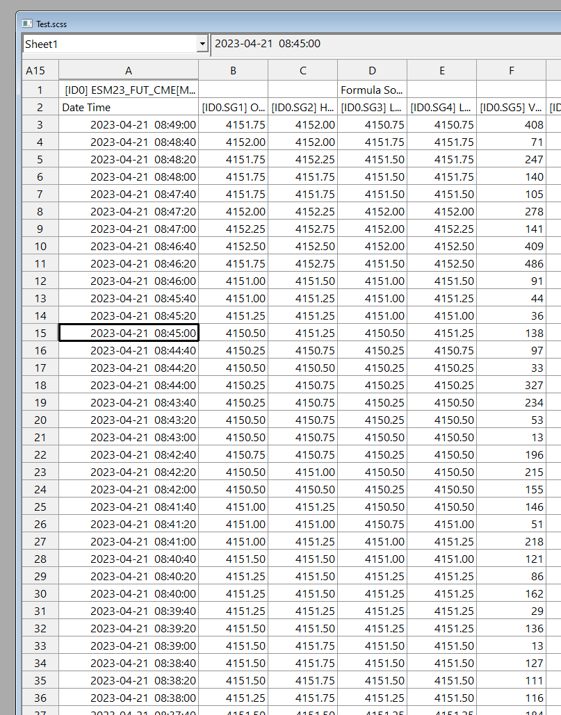

Sawtooth - Posts: 4361
Add the Spreadsheet Study study, then look in columns AA-AD.
You'll notice that the missing bars occur when the formulas return 0.

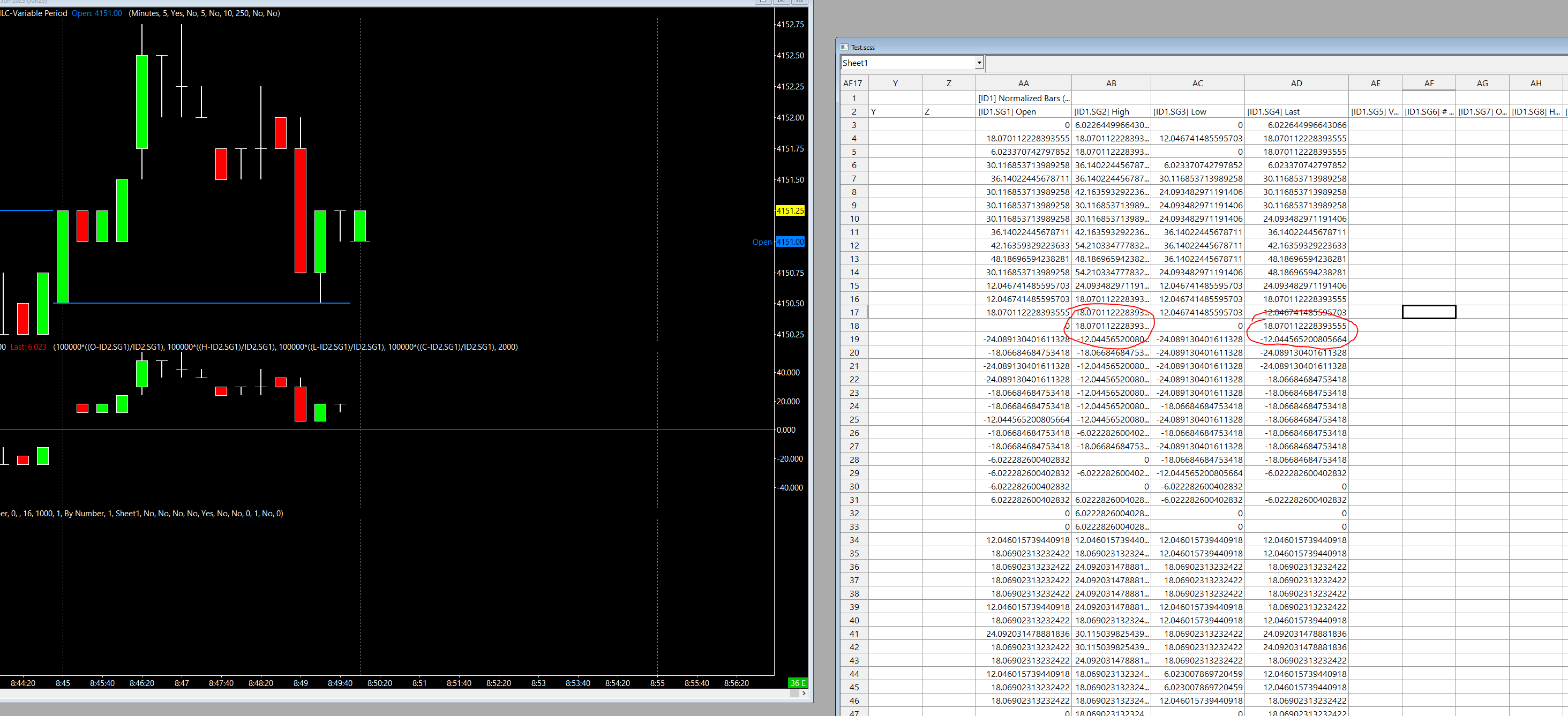

I did put spreadsheet study on and it on bar that's wrong has open 0, high 18.07, low 0, last 18.07 so it should have drawn a candle up with open and low at 0 and high and close at 18.07 but it didn't.
Attaching pics.

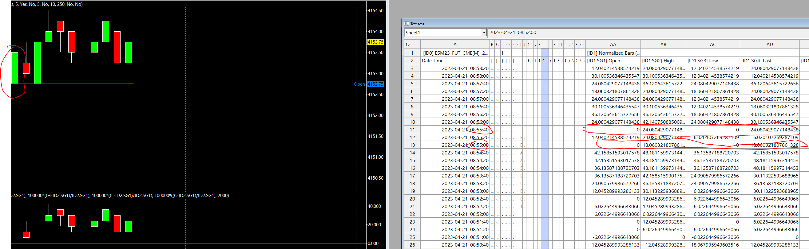

I shrunk the empty columns so candles and aa-ad are all visible two examples where open and/or low is 0 it doesn't work.

[2023-04-21 13:02:47]
The problem appears to be that when the value of OPEN or LOW is 0 it does NOT plot but it should in my opinion.

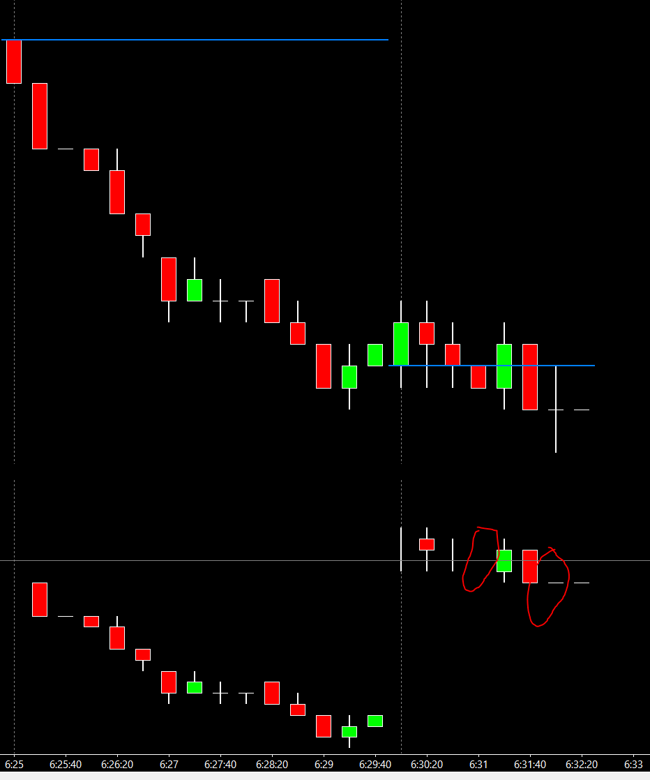

[2023-04-21 13:05:27]
If the open or close is a 0 ZERO it won't plot at all and it also does not plot the wick if its a 0 value!
The Spreadsheet Formula (Bar) study does not have an option to draw zeros.
Use these formulas as a workaround:
=IF((O-ID2.SG1)/ID2.SG1=0,0.0000001,100000*((O-ID2.SG1)/ID2.SG1))
=IF((H-ID2.SG1)/ID2.SG1=0,0.0000001,100000*((H-ID2.SG1)/ID2.SG1))
=IF((L-ID2.SG1)/ID2.SG1=0,0.0000001,100000*((L-ID2.SG1)/ID2.SG1))
=IF((C-ID2.SG1)/ID2.SG1=0,0.0000001,100000*((C-ID2.SG1)/ID2.SG1))

Thank you guys SO MUCH! I appreciate this more than you can imagine as from all the things I've tested this shows great promise to help keep me on right side of the trade and as a timing tool.
Working now!!
