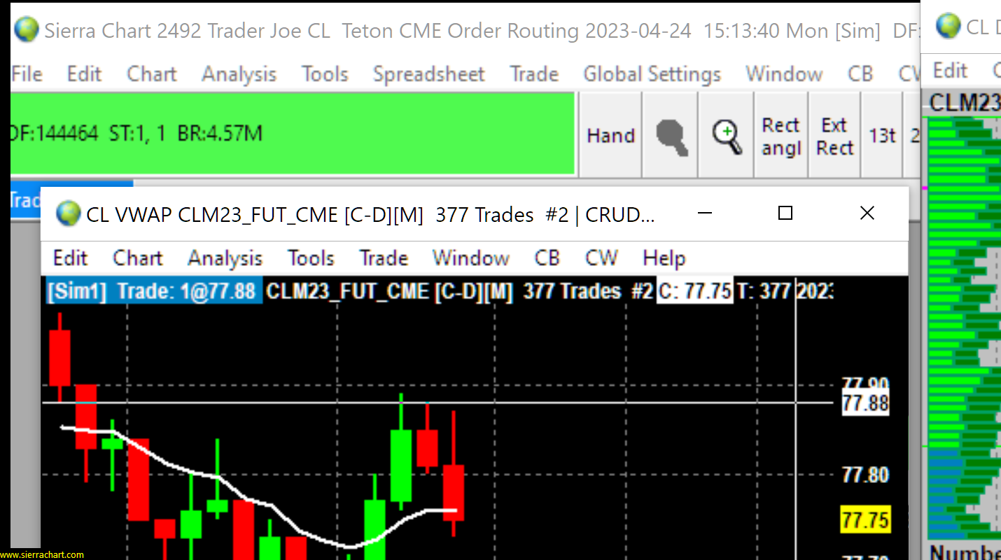

1. The Trader Joe CL.Cht chartbook is giving me fits. The components do not automatically load into the Chartbook frame; instead, all are behind it. When I drag them into the frame, they do not stay, unless I check Always on Top. https://www.sierrachart.com/image.php?Image=16823420215.png
2. IF I check "Tile as a Grid Vertically", they do, but not within the Chartbook frame. which I can see behind the grid.
3. No data is visible in the TPO Profile, the heart of the concept. There are two: Daily and Year. I have changed time frames, with no change in the chart. In the "TPO Profile Chart - Chart Values for Tools" window, there are only zeros. The start time is set to one second after Globex Open in my chart settings.
4. In his course instructions, he says these chartbooks are basic, designed for new users of SC. There is one file "Chartbook for Sierra.cht" that may be his heavy duty chartbook. This was sent to you last week in one of the previous chats. If you can please convert that to the current version of SC, I will be most appreciative.
Thank you.
[2023-04-24 16:32:41]
With regards to the charts and the way they are displayed, it is because the charts are "Detached" from the main window. If you want them to show up within the main window either one at a time, or tiled within the window itself, then go to each chart and select "Window >> Attach Chart Window".
If you do not have the menu bar at the top of each window, then follow the information at the following link to get the menu back and then select the option:
Chart Menu: Show Menu (Chart menu)
With regards to the TPO profile, open the chartbook and select "Edit >> Translate Symbols to Current Service". This sets the symbols for the charts to what you need based on your currently select "Service". Hopefully this will resolve the issue.
