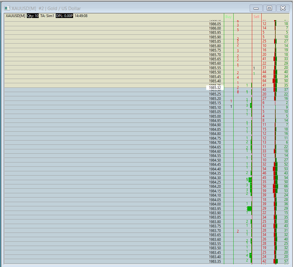

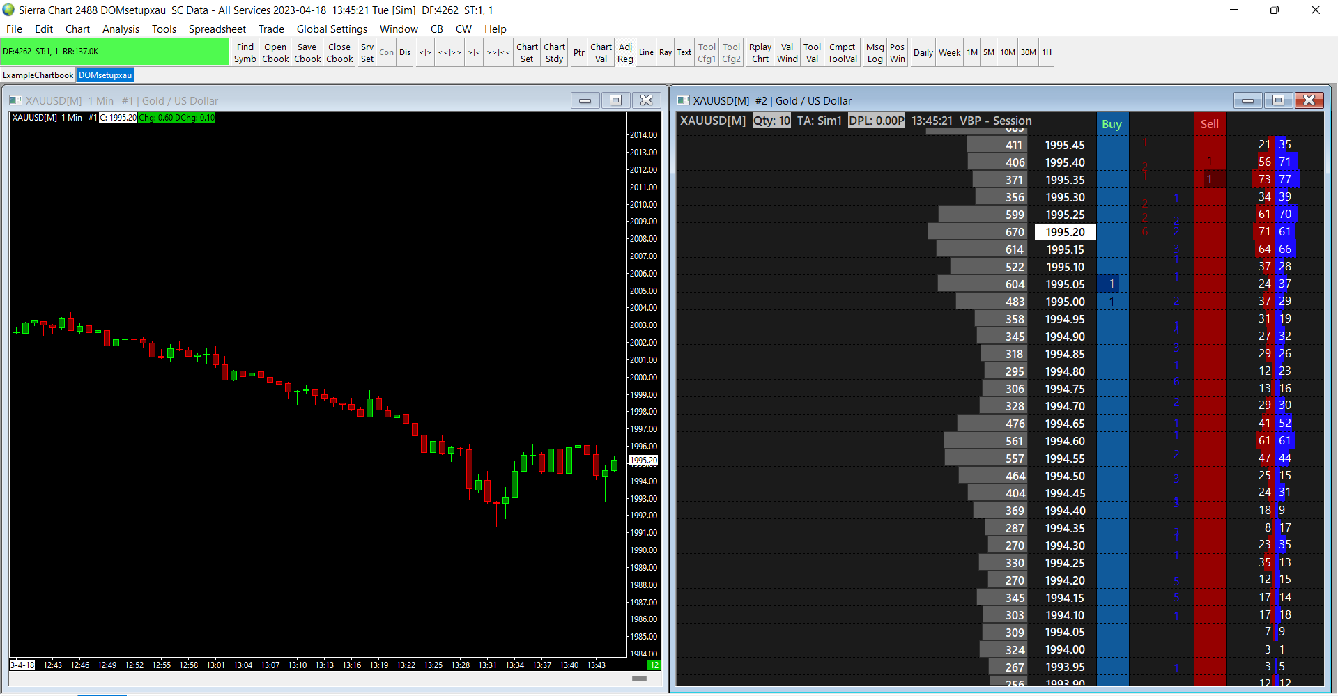

Ill be honest Ive spent days trying to figure out what is wrong with my DOM and even without any changes made it still doesnt display the data properly does anyone else have this problem

We do not see any particular issue. The spread between the Bid and Ask is what it is. You would have to check with the exchange about the spread if you have questions about it.
Also note that we do not have Market Depth data for the FOREX data.

when you get onto the depth of market tool the bars aren’t aligned with the table and the bars that show the volume are hard to read is it just because i am using it for forex? also what markets do you have market depth data for futures only?

The reason why you are seeing market depth data that is trading between the displayed values is because the Tick Size should be 0.01, whereas it looks like you have it set to 0.05. Change the Tick Size for that chart to 0.01 to have it line up as you expect.
But at the heart of the issue is the fact that there is no Market Depth data for the Forex and CFDs. The Futures and NASDAQ TotalView have market depth data.
