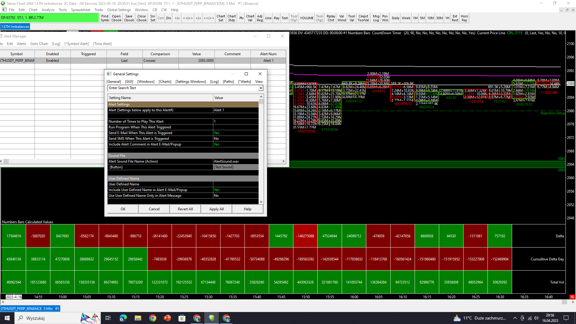

hello, my alerts are not working. I have everything set as in the manual but I don't get email notifications. how to fix it ?

Is it just a problem of not getting an email notification or the alert is not working altogether?
[2023-04-16 21:10:18]
Daniel Kamiński - Posts: 25
Alert is not working altogether
[2023-04-16 22:02:02]
Try changing the Comparison to "Above" or "Below" depending upon where the price is currently at and see if you get an alert.
Date Time Of Last Edit: 2023-04-16 22:02:51
[2023-04-17 20:53:09]
Hello, everything works after applying the advice, but only when the program is running.
[2023-04-18 14:33:48]
The program does need to be running to get the alerts. Anything you want to have happen within the local software requires that the program be running to have it occur.
