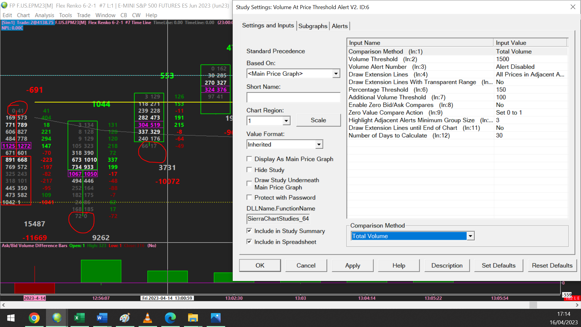

What I am trying to achieve is the inverse of the "volume at price threshold v2" study, i.e. I want to highlight a price level on the chart where the Total Volume is LOWER than the threshold rather than above it (or within a specified range).
The equivalent on a volume profile would be the extension of a "valley" instead of a "peak".
In the example picture there is a renko footprint... I want to be able to highlight/extend a level where the volume is e.g. 100 or less (even more helpful if I could define a set range). I have circled levels where the total volume at price was <100, I would like to highlight/extend these on a renko chart.
Many thanks
imageLVN query.PNG / V - Attached On 2023-04-16 16:18:40 UTC - Size: 533.58 KB - 334 views
If the VAP of interest is always at the H or L of the bar, you can do this:
- Add the Color Bar Based On Alert Condition study.
- Set the 'Output When Condition True' to 'Use Input Data'
- Set the 'Input Data' to 'High'
- Set the 'Draw Extension Lines At Color Bar Value' to your choice
- Set the Draw Style to Text (to not color the bar)
- Use this formula on the Alerts tab:
=VAP(H,0)<100
Duplicate the above study for the Low:
- Set the 'Input Data' to 'Low'
=VAP(L,0)<100
