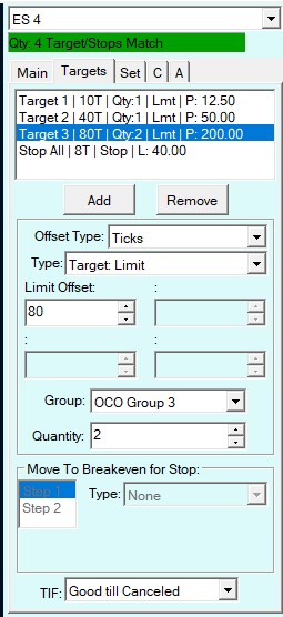

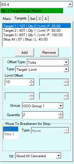

I have a saved OCO configuration with a quantity of 2 lots on Target 1, OCO Group 1, that seemingly randomly migrates to Target 3, OCO Group 3. If I select a different configuartion from the drop down menu, then re-select the one in question, the 2 lots will have reverted back to Target 1. Please see attached which will hopefully provide some clarity. The first image is the intended configuration. Thank you.
imageES4 Correct.jpg / V - Attached On 2023-04-14 17:54:38 UTC - Size: 46.64 KB - 242 views
imageES4 Incorrect.jpg / V - Attached On 2023-04-14 17:54:43 UTC - Size: 47.8 KB - 250 views

Had you changed the overall quantity at some point along the way, such that when you changed back to a quantity of 4, you simply did not end up with the same distribution as originally?
Selecting the configuration will definitely put everything back as it was when you saved the configuration.

Thank you for the response John. I don't think it's likely that I accidentally changed the overall quantity, particularly since it's happened multiple times, however I tried it as a test, toggling to to 5 lots and back to 4, and that definitiley caused the change to occur. May just delete it and start over. Thanks again.
