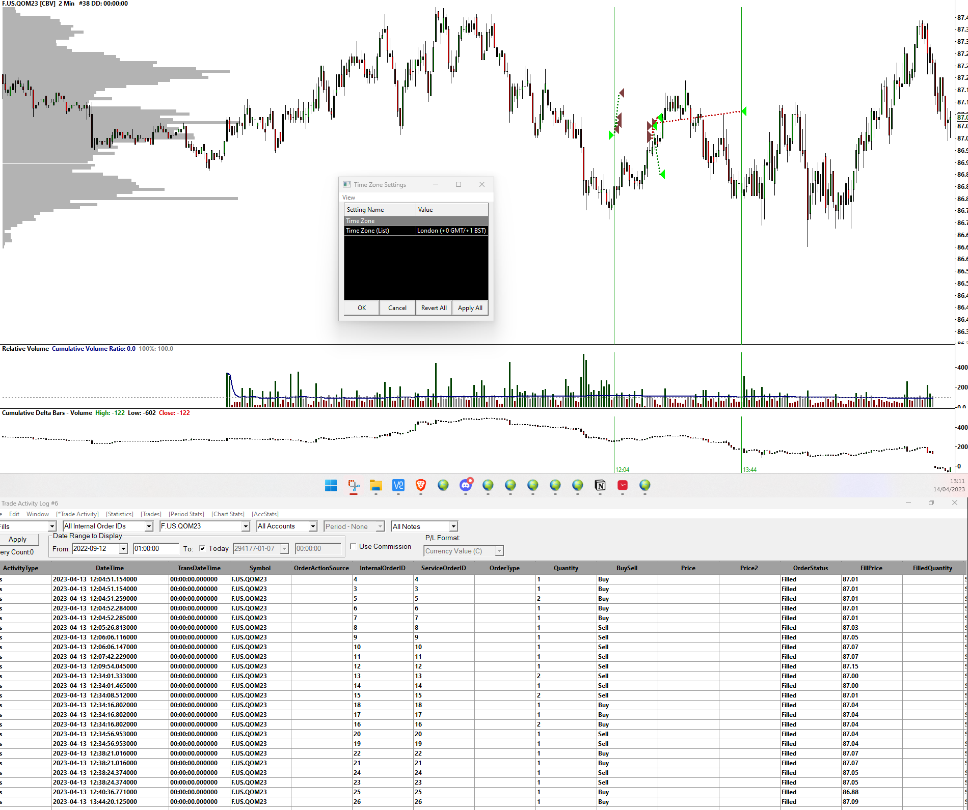

Thanks for the replies though I am still unsure. I have attached two screenshots to show what happens when I switch back from UTC+1 to UTC. The time axis corrects but my fills don't.
I know I can fix this manually by changing the time back 1 hour on each trade before I Import into the Trade Log but checking if there is a setting solution first?
imageUTC+1.png / V - Attached On 2023-04-14 12:15:29 UTC - Size: 227.87 KB - 173 views
imageUTC.png / V - Attached On 2023-04-14 12:15:36 UTC - Size: 154.24 KB - 168 views
[2023-04-14 12:35:42]
The fills must have a timestamp of UTC when you are using the Trade Activity import function. They must have the correct time stamp. There is no way to correct them subsequently by adjusting the time zone.
