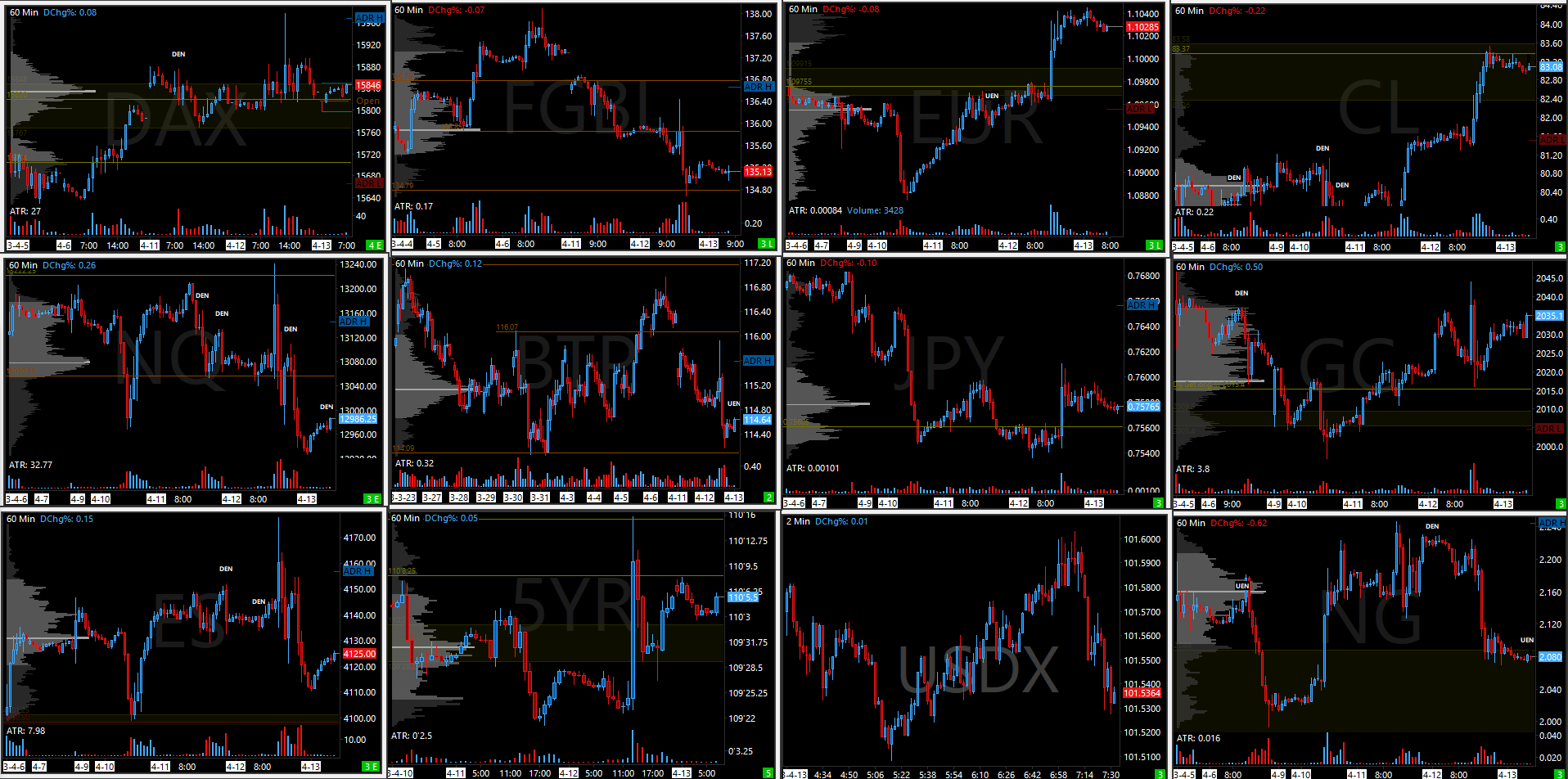

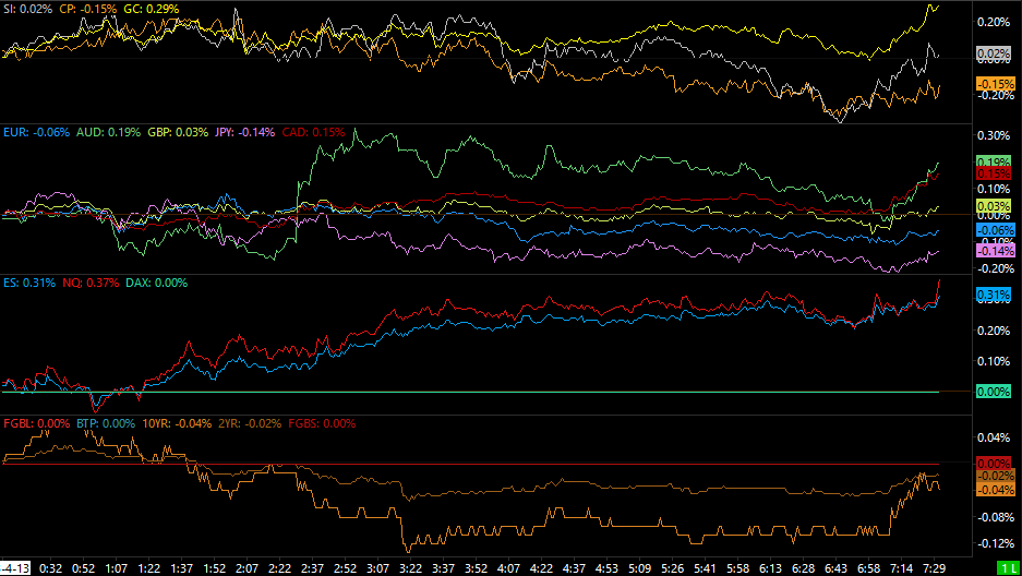

I have a chart that uses the add symbol study in combination with the percent change from last open study to plot products for comparison however it seems at random all Eurex products will display 0% some days when on other charts in the same instance it displays just fine. Appreciate any help thank you
imageScreenshot 2023-04-13 073208.png / V - Attached On 2023-04-13 06:33:43 UTC - Size: 56.92 KB - 278 views
imageScreenshot 2023-04-13 073251.png / V - Attached On 2023-04-13 06:33:58 UTC - Size: 194.58 KB - 184 views

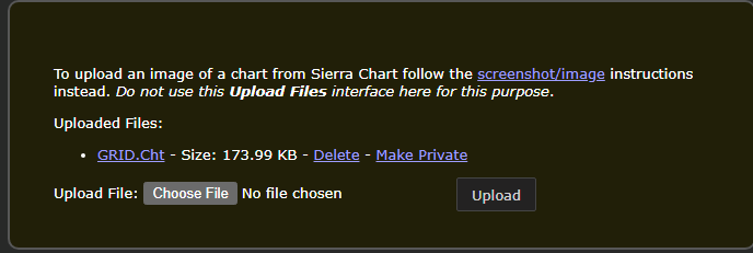

I have followed the instructions and attached the file in question
Date Time Of Last Edit: 2023-04-14 09:07:45
Private File
imageScreenshot 2023-04-14 073733.png / V - Attached On 2023-04-14 06:37:52 UTC - Size: 16.16 KB - 214 views

Hi the HG 1 Min chart that has all of the percent change from last open studies is the one with the issue, Occasionally the the EUREX products will only show 0.00%. Thank you
[2023-04-24 17:07:36]
We see an example of what you are seeing with ZN in the chart. The issue is that the study is looking at the first bar as defined by the Session Times, but if that bar does not exist (no trading at that time) then the Open is 0, which then causes the calculation for Percent Change Since Open, to be zero all the way across.
There is not a solution from our standpoint, as we do not know how people would prefer to deal with this (move on to the next bar, or leave it as it is).
