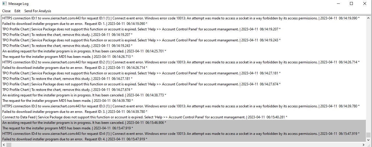

I trade evaluation accounts for APEX and SC suddenly stopped working. The Rithmic account is active as I can still execute orders via its app. Please find screenshot with the error message. Thanks in advance.

You need to update Sierra Chart to the latest version:

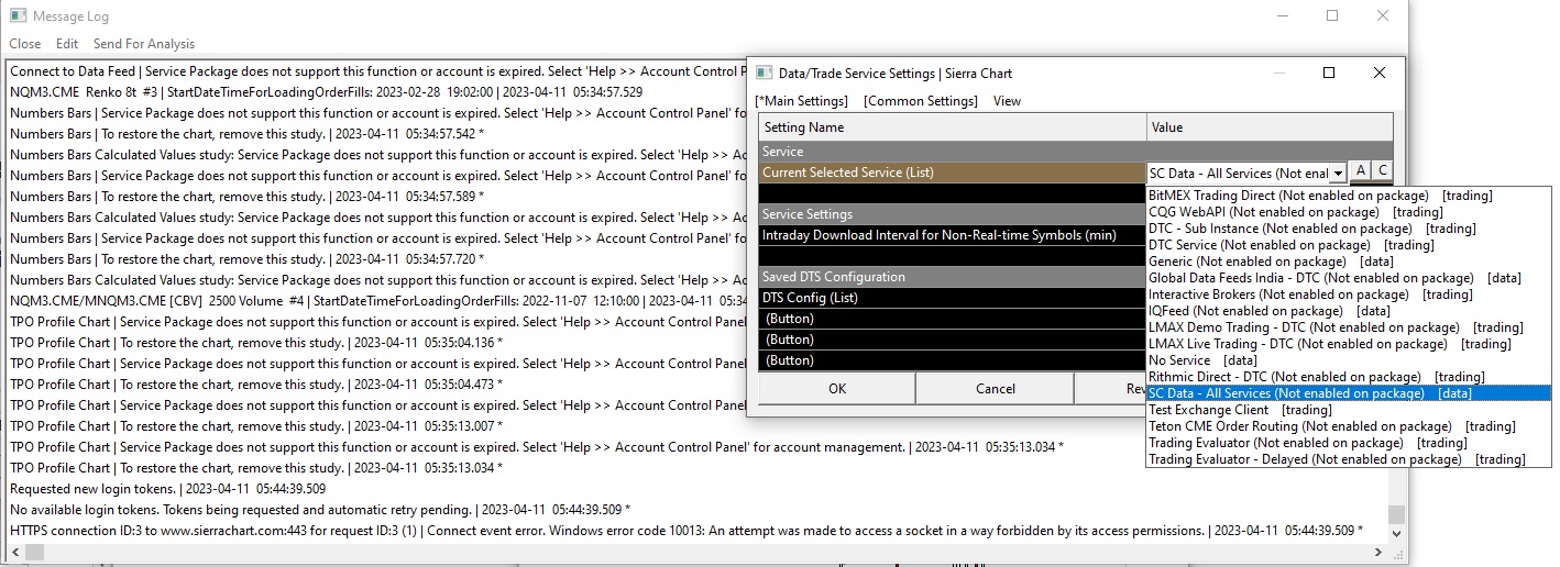

thanks for the quick responce. Just tried downloading current version but without success. The same error appears on the prerelease version as well. Picture attached

Looks like a network firewall in your system is blocking the connection. Try updating using the installer from here:
https://download2.sierrachart.com/downloads/SierraChartFileDownloader.exe

Thanks a lot, it was indeed the firewall. All sorted
