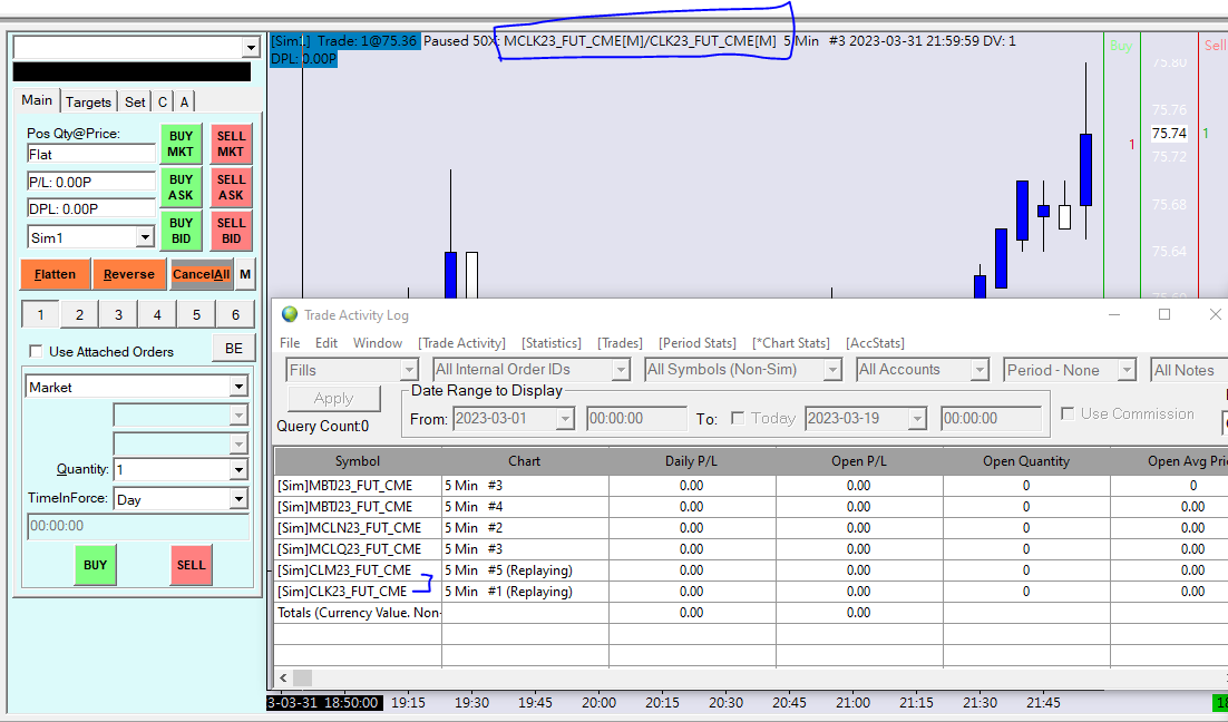

1. After I change the symbol to Micro Crude, I still see the previous symbol (standard crude) getting displayed next to it. What does it mean? How can I change so it doesnt display the previous one.
2. When I sim trade in replay I see the previous symbol gets traded, not the current.
Can you please advise.
Thank you!

There are two symbol entries on the Chart Settings window. They are the following:
- Symbol
- Trade and Current Quote Symbol
The way you have your chart setup, your Symbol is MCLK23_FUT_CME and your Trade symbol is CLK23_FUT_CME. So you are going to be viewing the chart for MCLK23, but trading CLK23. Refer to the information for these two items starting at the following:
Chart Settings: Symbol (text box) (Chart >> Chart Settings >> Symbol >> Symbol menu)
Unless you specifically want the above type of setup, you should not be using the [q]Trade and Current Quote Symbol[/b], but rather just change the Symbol entry.
[2023-04-13 20:19:15]
VLiviu - Posts: 223
Hi all,
I need an advice regarding charting some emini but trading its micro little brother.
Why would I do that? I got this recommendation and I need to understand why.
Thank you!
[2023-05-19 14:00:58]
Sierra_Chart Engineering - Posts: 25424
The reason you would do this is because you will have a more complete chart using the emini symbol. But there is less margin and risk involved in trading the micro contract.
