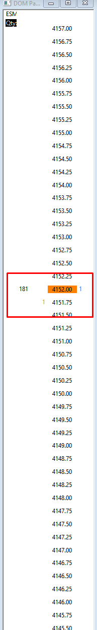

I am fairly new to Sierra Chart. Last week I used the Market Replay feature. I mainly use the DOM. I use a live denali data feed.
In the beginning I could see 10 limits above and below the current price. Everything worked fine.
Since Friday I only seen 1 limit order on both sides that doesn't even change anymore.
I have already tried the following:
-Sierra Chart Server Settings - Support Downloading Historical Market Depth Data - Yes
-Sierra Chart Server Settings - Max. Historical Depth Days to Download - 100
-Chart Settings - Market Depth - Maximum Market Depth Data Days to Load - 100
Do you have any additional idea?
Thanks!
imageDOM.png / V - Attached On 2023-04-04 16:21:38 UTC - Size: 15.52 KB - 348 views
