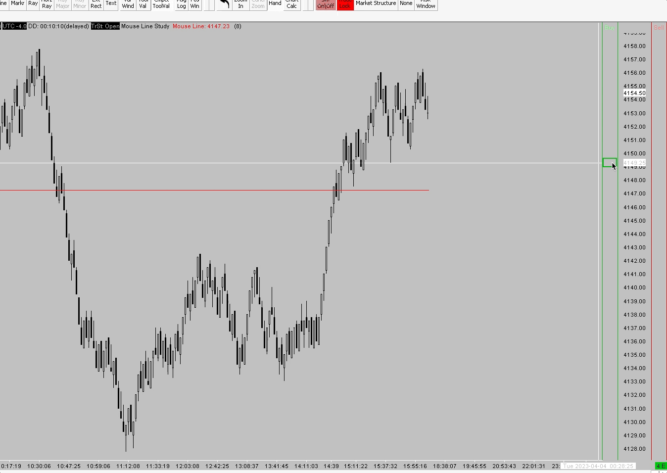

I believe that drawing a parallel line to the horizontal one in the crosshair to visualize where the Stop Loss is going to be placed it would help.
Is there a way to add a parallel line to the existing crosshair in order to have a preview of where the SL level is going to be before we place the order, while we move the mouse?

It could be done by taking the Y position of the mouse and then updating data to draw a horizontal line at the position above/below where that Y position exists. Refer to the following:
ACSIL Interface Members - Variables and Arrays: sc.ActiveToolYValue

Well, it has a little delay, but it works.
Here you go, the study.

If you do not already have it set, make sure you have the option for sc.UpdateAlways set to True for your study. Refer to the following:
ACSIL Interface Members - Variables and Arrays: sc.UpdateAlways
