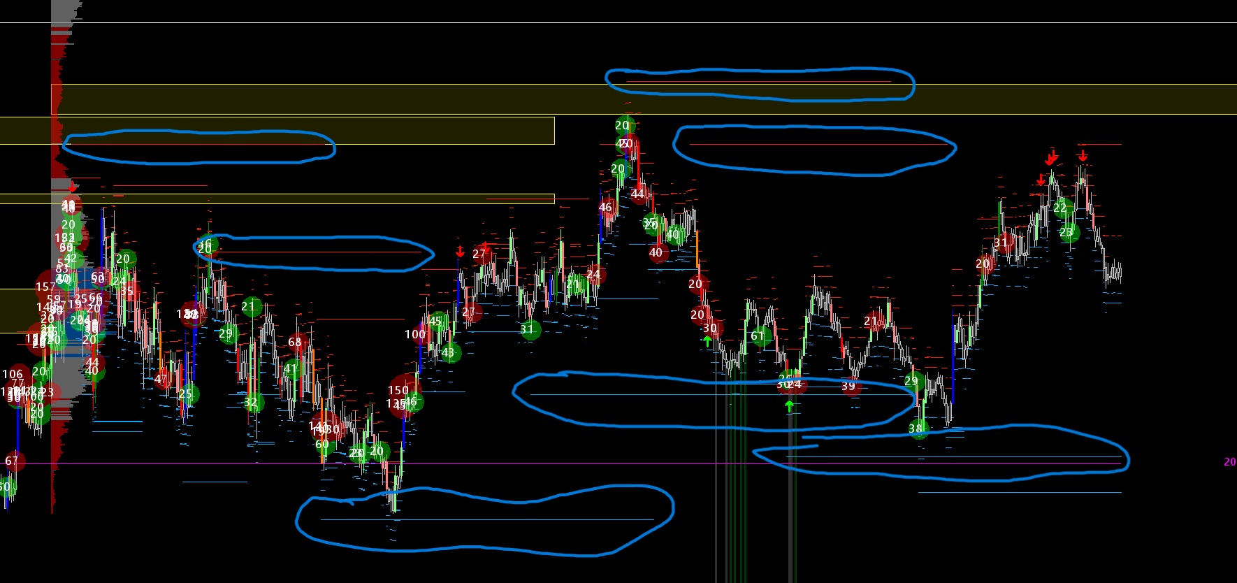

Hi there.. I'm trying to eliminate the noisy algo/bracketing liquidity around the price, and only display/isolate the resting liquidity that has been there for a 'while'. I can't see a way to do that via the existing settings, but think I could get close to what I want if there was a setting like 'Only display liquidity that has been present >x minutes' which I could probably leverage to eliminate the noise around the price. Is that something you would entertain adding to the study (or can you think of a better way to get to what I'm trying to do).. screenshot attached of the liquidity that is important to me.
imagemdhg sierra board.png / V - Attached On 2023-03-22 22:42:26 UTC - Size: 160.63 KB - 299 views
[2023-03-23 13:16:33]
There is not a way to do this with the existing tools.
You could create a custom study to check for this and then give you a line drawn where you want. Refer to the following:
ACSIL Interface Members - Historical Market Depth Data (c_ACSILDepthBars)
Otherwise, this is a Feature Request, and we have marked it as such, but we can not say when we will get to any particular feature request.

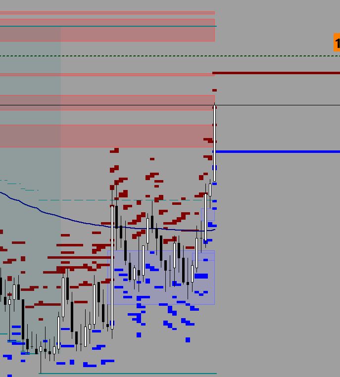

User279510 - Posts: 21
Is it possible thru the ACSIL interface to remove the historical prior MDHS bars? I would like to be able to see just the current large orders with this study and not the prior bars that really clutter up the view. Thanks
