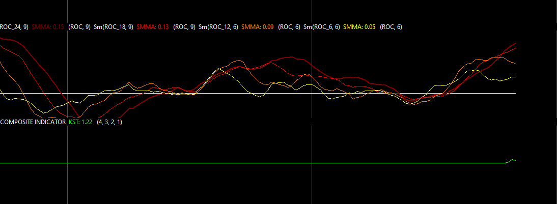

Hello I just coded a study in ACSIL that should display a line.
The problem is that it only start to diplay the line from the moment I upload the study to the chart (as you can see on the screenshot).
I tried to add a sc.DataStartIndex statement but it does not solve the problem.

imageCapture d’écran 2023-03-22 163422.png / V - Attached On 2023-03-22 15:34:35 UTC - Size: 61.02 KB - 176 views
[2023-03-22 15:45:42]
User431178 - Posts: 910
if (sc.IsFullRecalculation)
return;
You will skip all bars during the initial calculation because of the above code.
