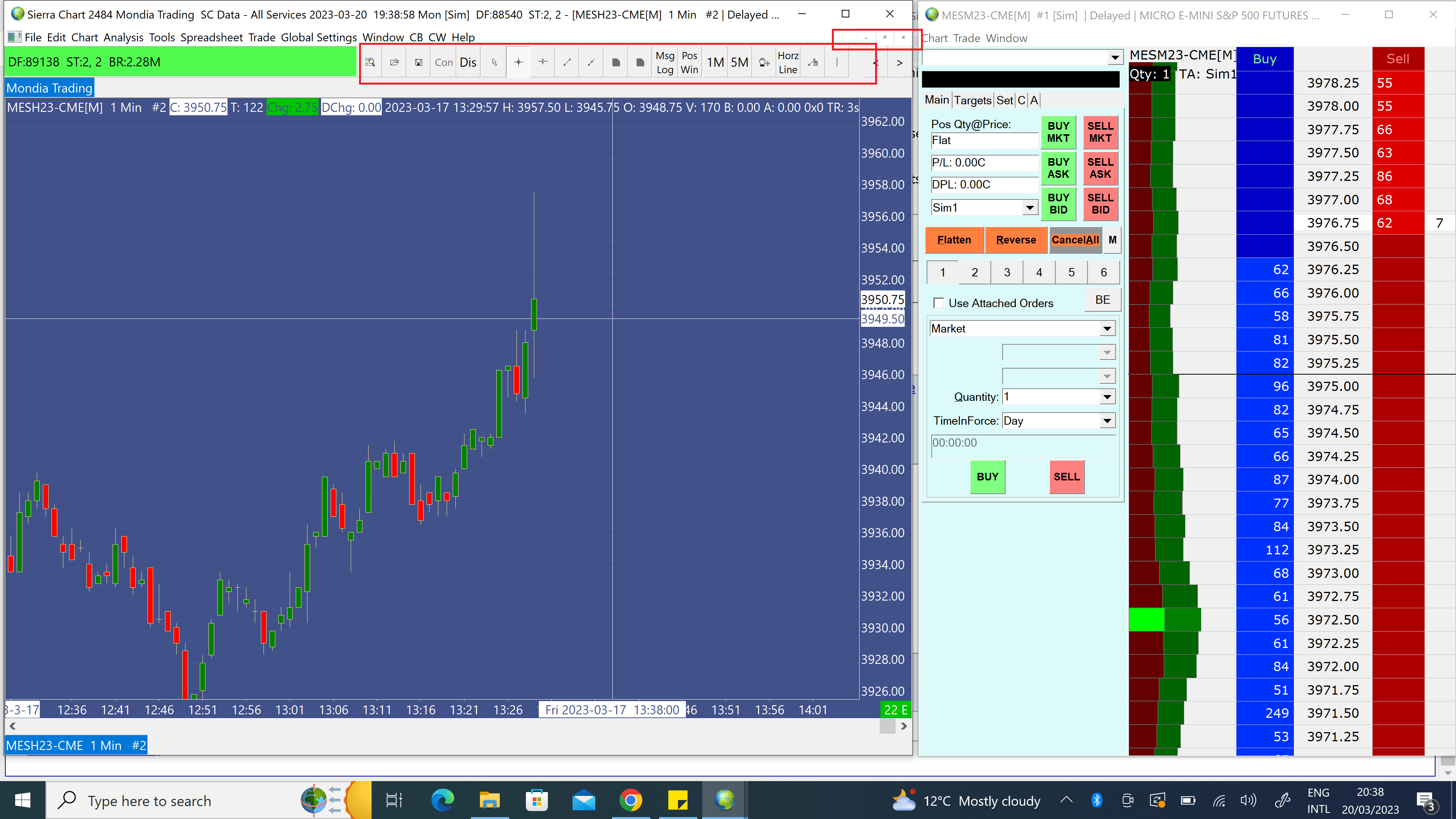

I have an issue with the software it show all things small and not organizaed
can you please assist me to solve that issue before subscribe and start using the app for trading
thank you so much
imageUntitled.png / V - Attached On 2023-03-20 14:48:07 UTC - Size: 932.07 KB - 254 views
[2023-03-20 17:39:10]
Offhand, it looks like the particular Chart you have open is set to have its own Graphics Settings rather than the Global Graphics Settings. This means that it has the setting for Chart >> Graphics Settings - Chart >> Use Global Graphics Settings Instead of These Settings not checked. Refer to the following:
Graphics Settings: Using Different Color and Graphics Settings for Specific Charts
If you want the chart to use the Global Graphics (assuming those are setup the way you want) then make the chart the active window, and select Chart >> Graphics Settings - Chart and then enable the option for Use Global Graphics Settings Instead of These Settings.
If it is not the above, then you will just need to adjust your Font and Color settings as you want them to be. Refer to the following about fonts, in particular:
Graphics Settings: Fonts

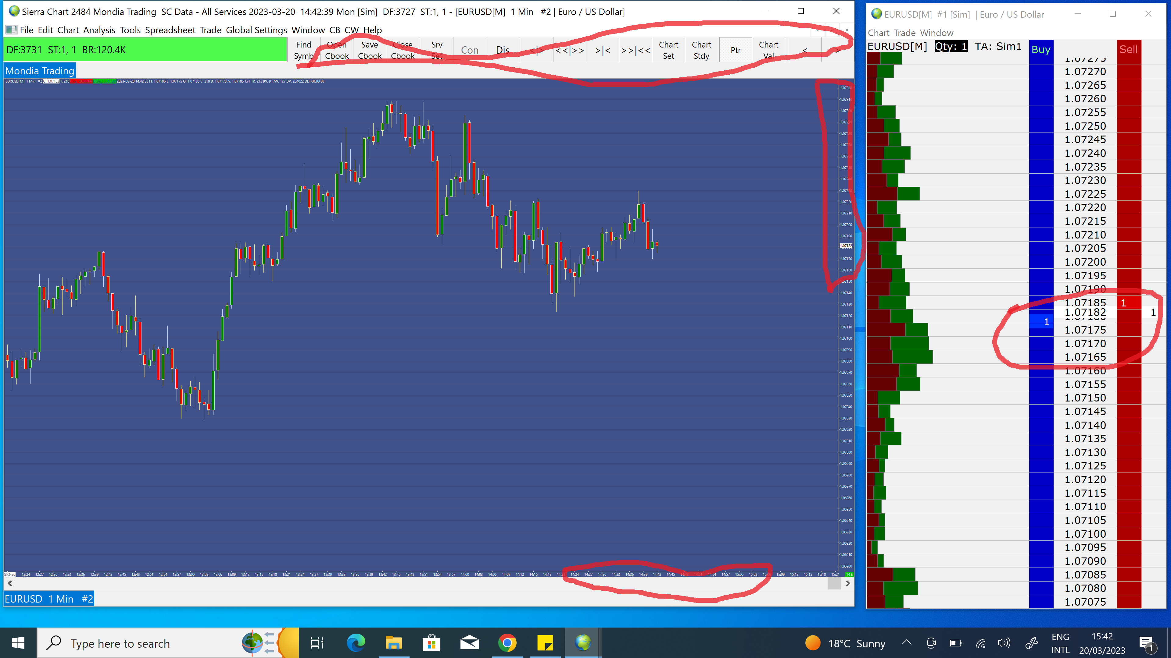

i still have an issue with control bar are look very small icons see the screenshot
imageUntitled2.png / V - Attached On 2023-03-20 20:07:10 UTC - Size: 543.74 KB - 255 views
[2023-03-20 21:55:59]
The images that are used for the Control Bars are a certain size, so if you want them to be bigger, you would have to increase their size. You can do this in MS Paint with the "Resize" option easy enough. We can not tell you the size you would need though, as it depends on the size of your screen and how large you have your Control Bar Buttons set. You would have to just try a few options to see what would work best.
