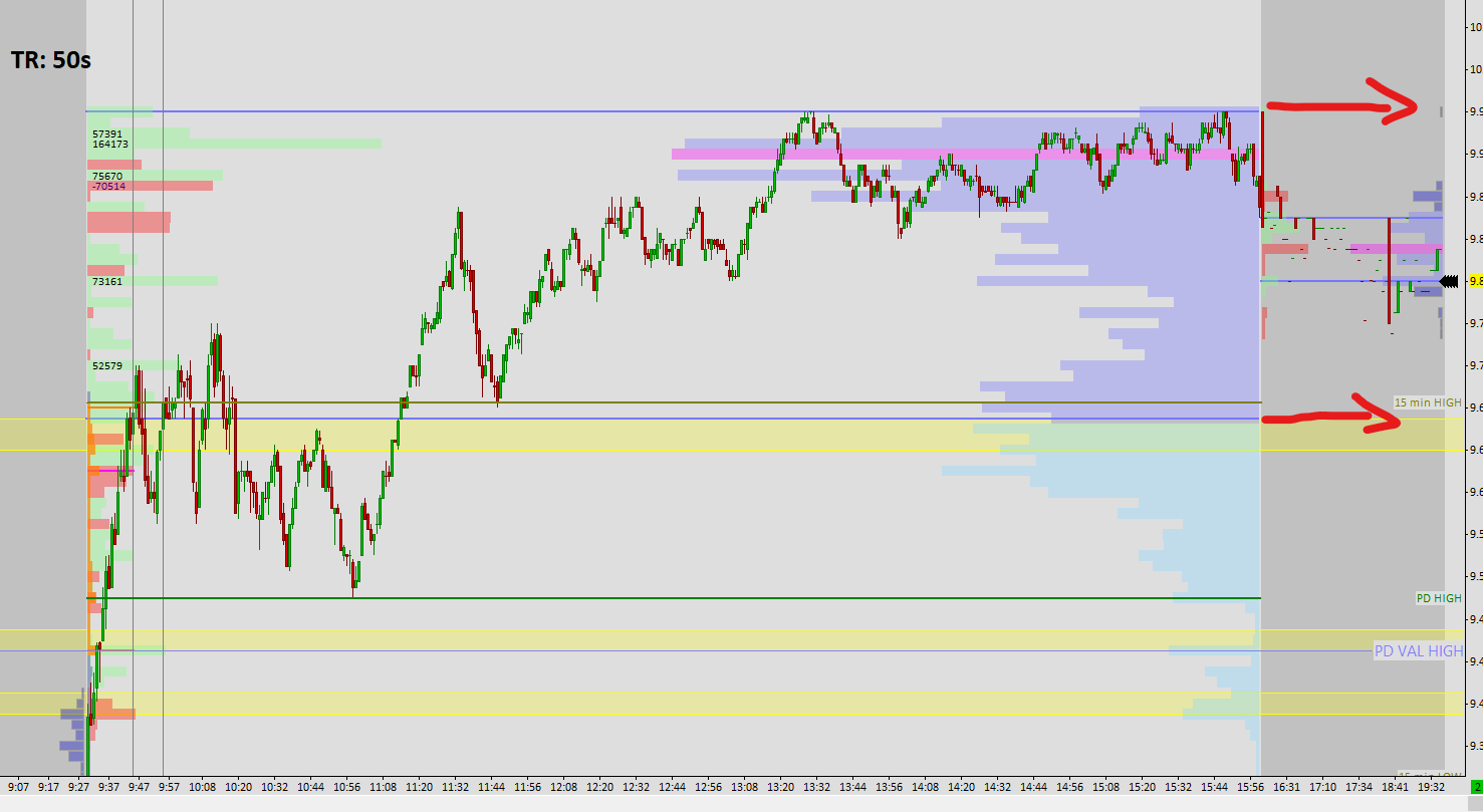

I have my volume profile right aligned, but I want to extend the value area high and low forward 1 day only (red lines in attached pic). I can't seem to figure out the right settings to do this?
imageval area.png / V - Attached On 2023-03-19 00:10:32 UTC - Size: 46.04 KB - 297 views
[2023-03-20 16:43:58]
Set the Input on the Volume by Price study for Extend Value Area to End of Period.
Refer to the following:
Volume By Price Study: Extend Value Area
[2023-03-22 00:39:36]
fish4trout - Posts: 99
Thanks, but when I do that it extends value area to the left. I want the value area extended forward to next day (red arrows).
imageval area 2.png / V - Attached On 2023-03-22 00:39:26 UTC - Size: 44.14 KB - 415 views
[2023-03-22 14:32:57]
To have the lines in the next day, you would need to use the Volume Value Area Lines study and set the Input for Reference n Periods Back to 1. Refer to the following:
[2023-03-22 23:05:25]
This worked thanks!
