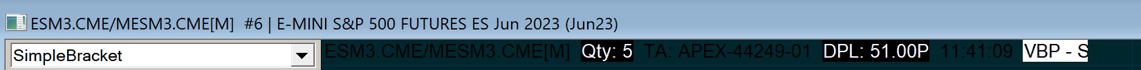

Using Denali as charts. I've tried various things but the trades are going through to Rithmic as emicros instead of eminis. How do I keep my DOM and make it and the attached trade window trade minis?

Why are you stating that they are going to Rithmic as E-Micro instead of E-Mini. In particular, if you are basing this on the currency value of the trade results, then make sure that you have the correct Currency Value per Tick entered for the chart. Refer to the following:
Chart Settings: Updating Currency Value per Tick for Trade Symbol
[2023-03-16 18:05:07]
User963805 - Posts: 12
Dear John thank you for your patience.
I'm stating it because in RTrader the symbol for the trades taken is MESM3 which is the ES emicro.
Was it wrong of me to assume that if my chart is ESM3 then I would be trading minis not micros.
So are you saying that irrespective of whether the chart symbol is minis or micros the currency value has to be set for every chart?
[2023-03-16 22:20:34]
You have the Micro setup as a "Trade and Current Quote Symbol". As such, when you place a trade on that chart, it is going to send the order for the MESM3 symbol.
If this is not what you want, then remove the entry for MESM3 in the "Trade and Current Quote Symbol". Then when you place an order on this chart, it will be for the ESM3.
