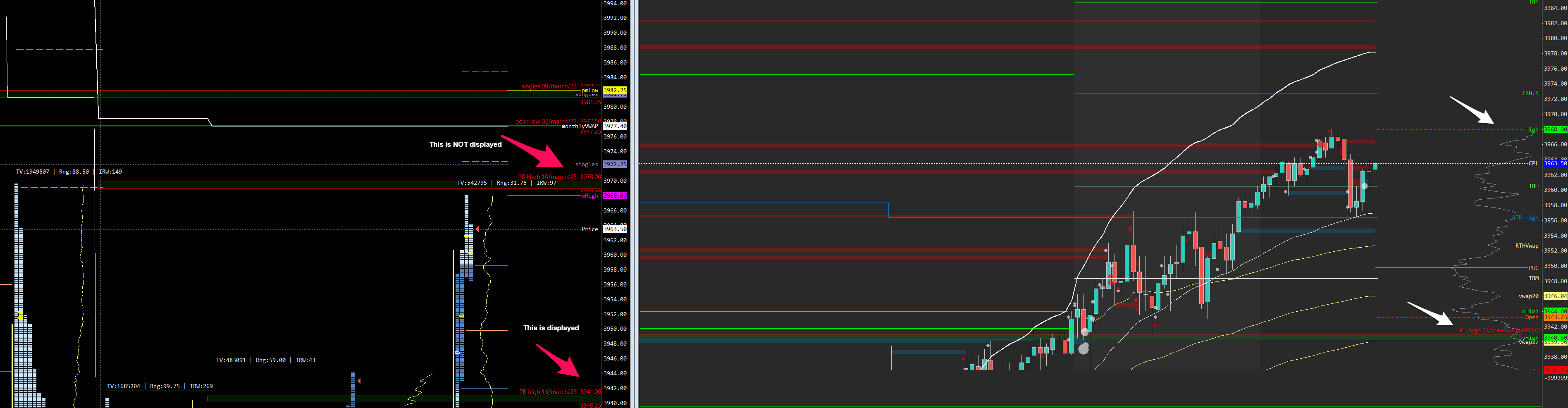

I did the rollover from March to June (ES), and some of the drawings I have on my TPO chart are not displayed on my execution chart. I am attaching an image of the example.
On my execution chart I have Chart Drawings -> Copy from, and the TPO chart number is there, like always.
What I did this morning is to aligned the levels, following the instructions from here Adjusting all Support/Resistance zones after rollover | Post: 94579
imagetpo-execution-no-drawings.png / V - Attached On 2023-03-14 15:10:51 UTC - Size: 344.93 KB - 274 views

There are a few options to get the drawings to show. Just first be aware that when you rollover, if you are using the option Chart >> Perform Futures Symbol Rollover, then there is an option on that window for Also Rollover Chart Drawing Symbols.
Since this is after the fact, you can go to the Tools >> Manage Chart Drawings Winwdow and update the Symbol for the drawings that need to be update.
Or, you can just select the option for Chart >> Chart Settings >> Chart Drawings >> Show Chart Drawings for Different Symbols.

thank you very much! the last option helped when I selected that in the execution chart, I appreciate your quick and effective response.
