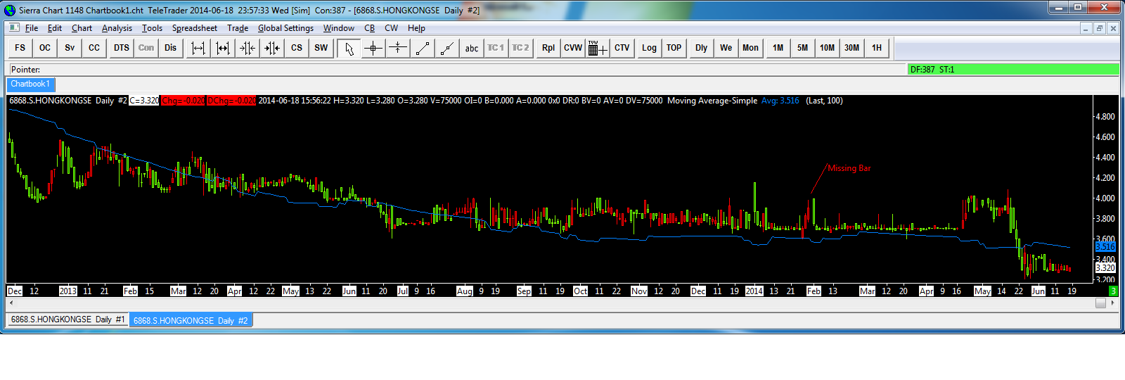

But I found another new issue, SMA100 seem didn't calculate correctly.
I realized that TeleTrader does have some bad tick, but those few bad tick shouldn't made SMA100 run out so much.
Attachment is my current charting software with SMA100, it is a lot smoother.

[2014-06-18 16:55:32]
Make sure the Scale Range for the Moving Average study is set to Automatic and also for the chart as well. Here is the documentation for the Scale settings:
http://www.sierrachart.com/index.php?l=doc/doc_Scaling.html

[2014-06-18 22:36:55]
Can you please attach the Historical Daily data file for that symbol of the chart, to this thread. You can see the file when you select File >>New/Open Historical Chart.

[2014-06-19 10:04:51]
We see the problem. Go to Edit >> Edit Data-Historical Chart.
You will notice that sometimes the close price is 0. This is throwing off the calculations.
Go to the Moving Average study and set the Input Data input to High Low Average (HL Avg). You probably should contact TeleTrader and see why they are providing 0 sometimes for the closing price of a daily bar.
