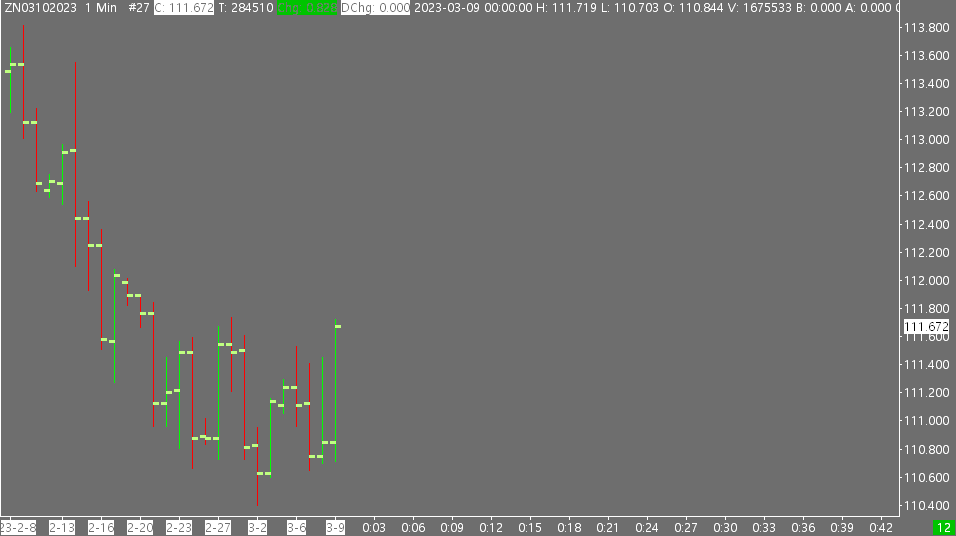

| [2023-03-14 14:30:24] |
| User727773 - Posts: 14 |
https://www.sierrachart.com/image.php?Image=1678804197367.png

| Sierra_Chart Engineering - Posts: 25481 |
What symbol is that? Must be an issue with the source of the data. Sierra Chart Support - Engineering Level Your definitive source for support. Other responses are from users. Try to keep your questions brief and to the point. Be aware of support policy: https://www.sierrachart.com/index.php?l=PostingInformation.php#GeneralInformation For the most reliable, advanced, and zero cost futures order routing, use the Teton service: Sierra Chart Teton Futures Order Routing |
