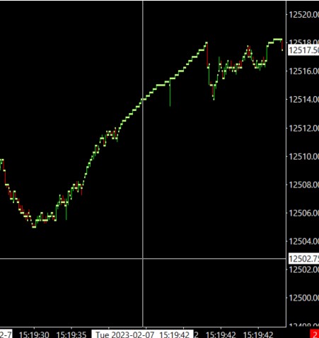

I have read that page multiple times. What I am asking happens only during very volatile moments while using a volume per bar candles.
In the attached image, each of the candles in the stair step section going up has the same closing time.
How can a study compute these candles in time? What happens internally? Are candles skipped? What about trading decisions?

We have no further information other than what is documented on that page. Some of these questions you just have to answer yourself:
And you can also answer all of your questions just simply by doing step-by-step debugging or adding log messages and observing what the study function is doing.
No so long as you have implemented the study function properly:
