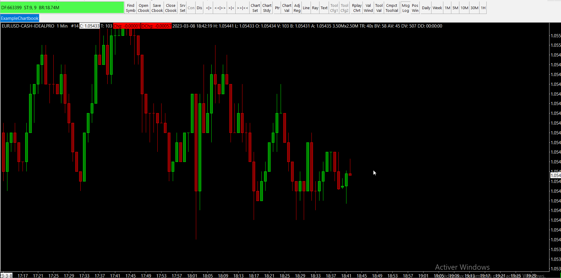

I have just recorded a gif of an attempt to take a position on the euro-dollar index, there I do not even have the positions that are displayed on the graph.
I need help please, I've been trying to configure sierra for over a month and I can't get it to work.
imagesierra.gif / V - Attached On 2023-03-08 18:51:37 UTC - Size: 16.88 MB - 258 views
[2023-03-08 22:42:00]
The main thing we see in the gif you provided is that you are trying to enter a Limit order (as the primary), but you are not entering the Limit price (it is 0.0000). You need to enter the Limit price on the Trade Window before you can select the "Buy" or "Sell" buttons. Otherwise, you will get the error you are.

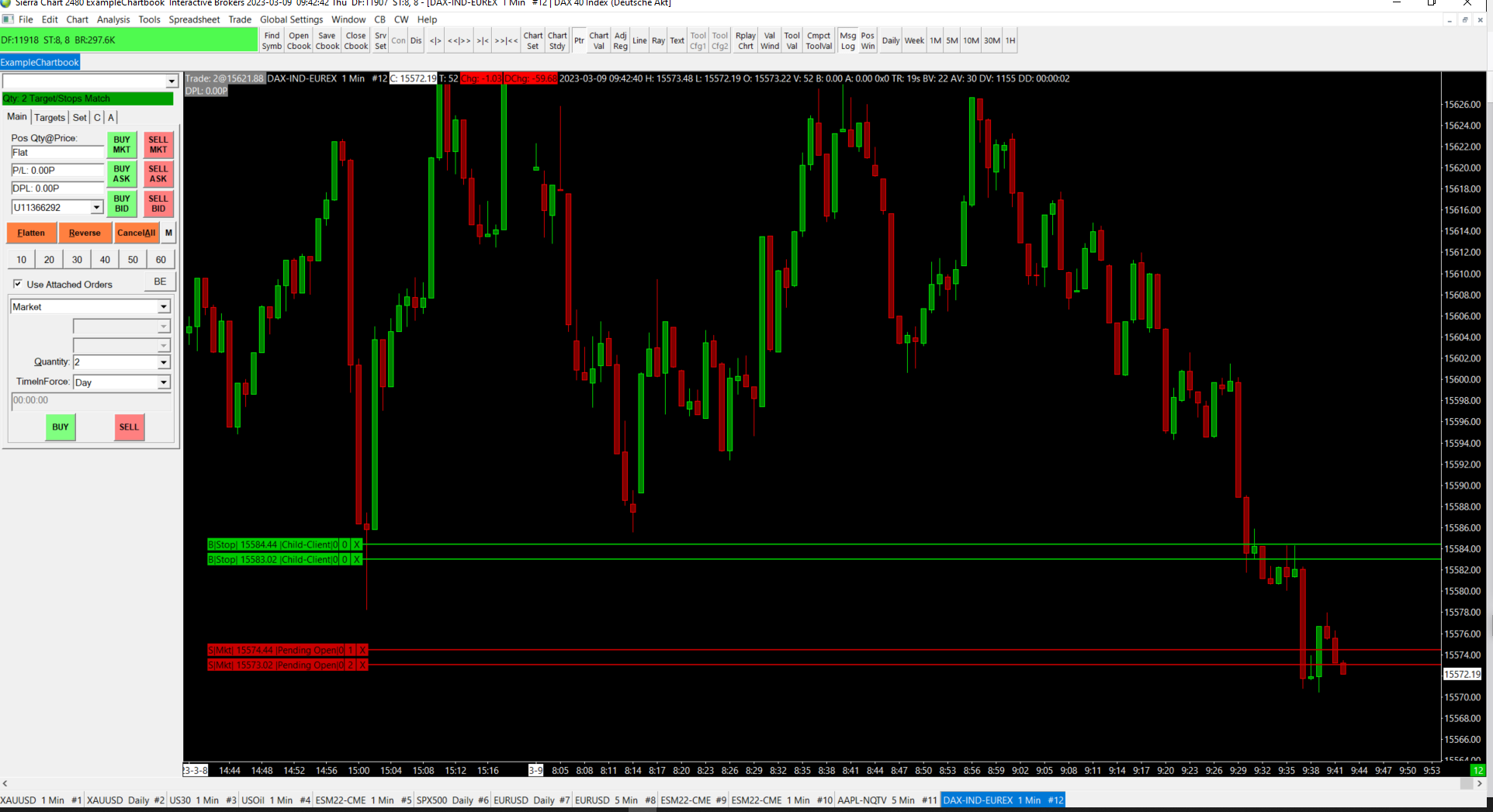

usually, I trade the dax index.
In the attached screenshot, we can see that my positions are still in pending open and are not taken into account, how to correct this please
Thank you

[2023-03-09 15:10:46]
We need to see your Trade Service Log when you place the order and it is staying in a Pending state.
The Trade Service Log you sent makes sense, given that you did not have an open order, therefore selecting Flatten does not apply - but your child orders were then cancelled. But this does not give us the information on why the orders are staying in a "Pending" state.
Also, check with Interactive Brokers after you place an order and it is Pending, as it is possible that the order went through, but then we are not getting any updates from IB on the status.
[2023-03-09 18:03:34]

[2023-03-09 19:02:27]
What kind of order are you putting in?
[2023-03-09 19:50:42]
jubakerdel - Posts: 13
Market orders , you can see the screenshot below
imageCapturesieeea.PNG / V - Attached On 2023-03-09 19:50:34 UTC - Size: 249.91 KB - 256 views
[2023-03-10 09:20:09]
You cannot trade an -IND- symbol through Interactive Brokers. Those are nontradable.
Also one thing we noticed in your video, is when you select a Trade Window configuration, any changes you have made to the to Trade Window like in this case having previously set the tick offset for Attached Orders, will be lost.
We really do not recommend trading your Interactive Brokers account through Sierra Chart. We do not want to support that and you will have problems.
Just use Sierra Chart for charting and only enter orders through TWS. And rely upon Interactive Brokers for trade support. We do not want to provide any further support to you in this regard. You will have problems! Take our advice.
