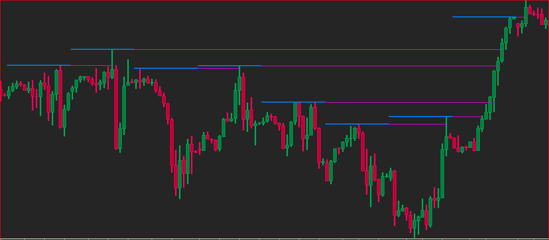

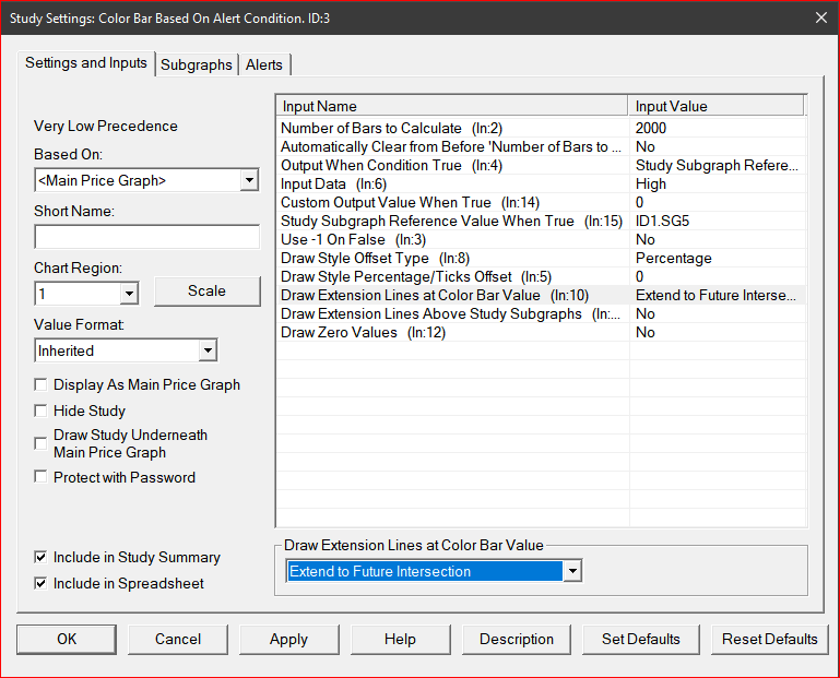

See attached pic for the settings I used.
SG5 is the column O on the spreadsheet.
I'm certain what you want to do is possible.

imageExtend SS subgraph to future intersection.PNG / V - Attached On 2023-03-08 04:27:36 UTC - Size: 40.21 KB - 239 views
imageExtend lines to future intersection.PNG / V - Attached On 2023-03-08 04:28:23 UTC - Size: 21.82 KB - 301 views

mattvk - Posts: 37
Tomgilb, thank you for the screenshots! I had "based on" set to the spreadsheet study instead of the main price graph (as specified in the docs). Now it's working as intended, with the extension until the next price intersection. Very helpful, thank you again for your guidance.
