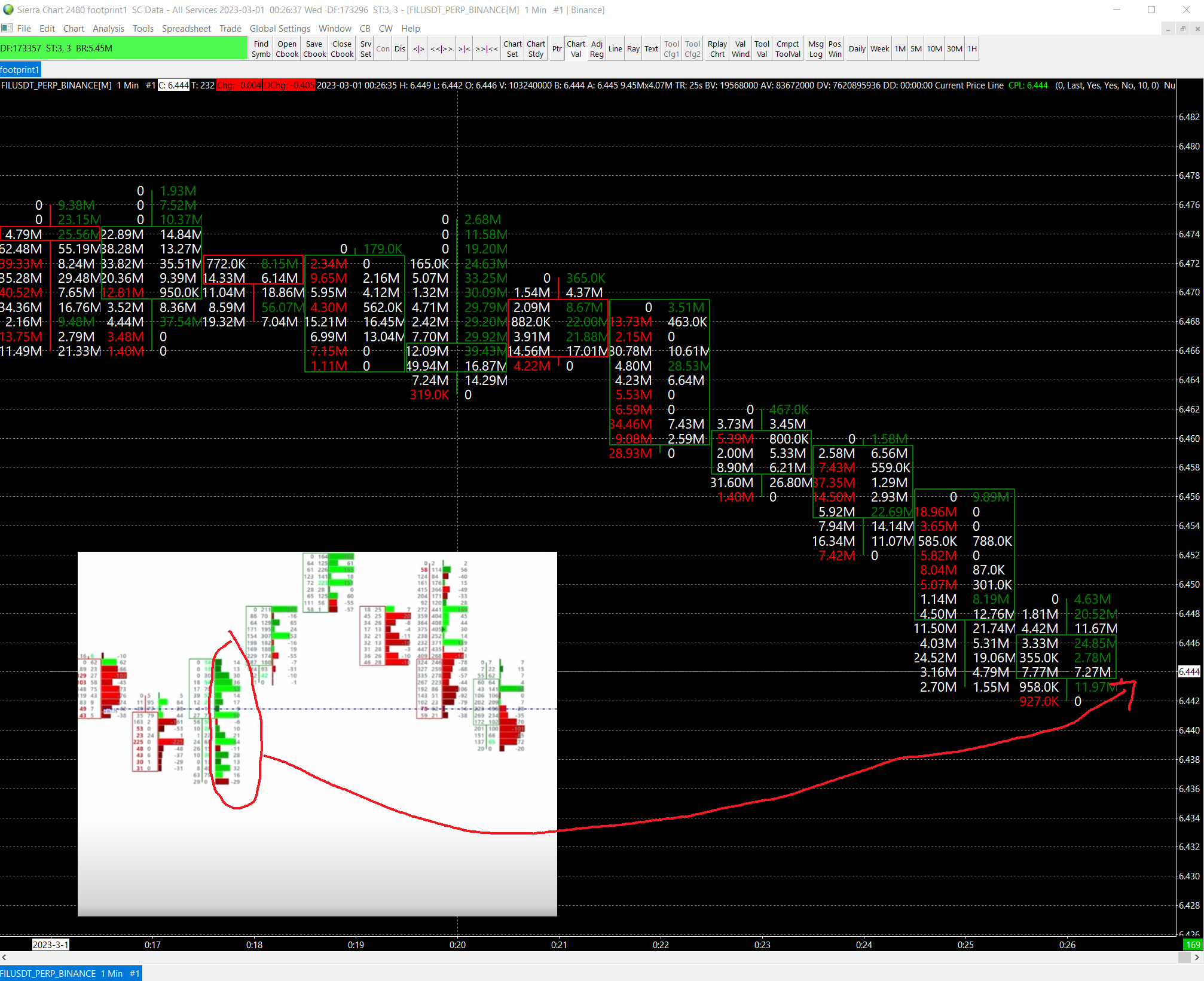

Hi!
Please help me, how add this accessory to my number bars right side, what I circled with red color. I attached photo to my post. I hope somebody helping me, Thanks!

The Numbers Bars study has 3 column options. Your chart is just using the first column. In the image you provide they have setup the 2nd column to display data and bars.
When you look at the Inputs for the Numbers Bars study, you will see the same group of information repeated from the top, where you have "Column 1...", then down about 12 lines is "Column 2...", then "Colum 3..." and then "Pullback Column...". You just need to setup the Column 2 items the way you want them.

Thanks you, I setting colum 2 with some thing what I need, and works well!
