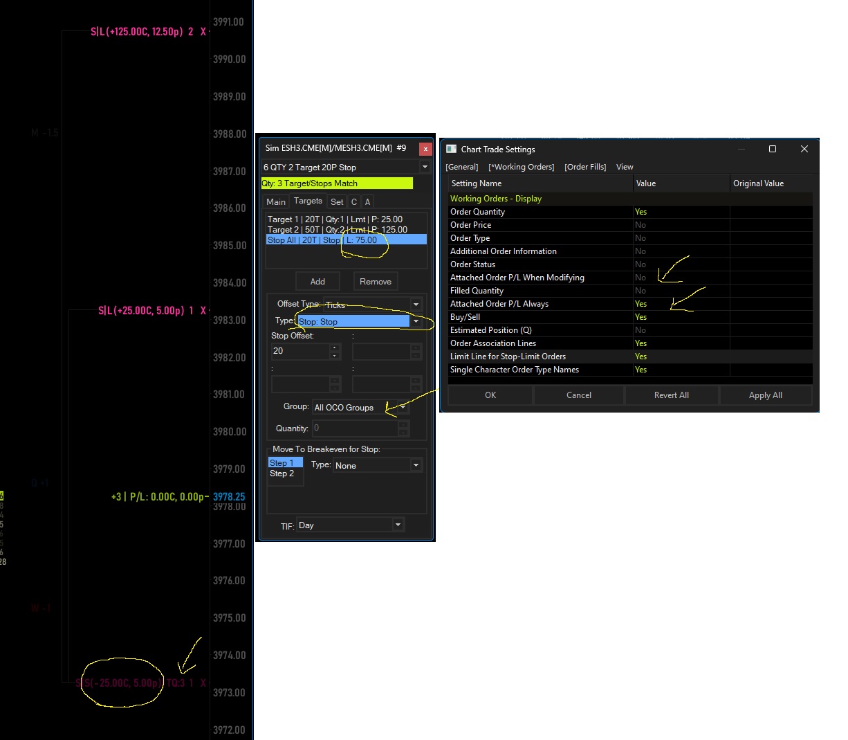

When I place an order using "attached order" my stop loss calculation is displaying the currency/point value for only the first target. For instance, I enter a 3 lot position, the first target/stop is for 1 lot and has a stop value of 5 points and displays -25.00C (1.25 per tick). The second target/stop is for 2 lots and has the same stop value of 5 points, which is -50.00C but this value is not displayed or maybe its hidden below the other stop value? I would like the stop value to calculate and display for the full position size, which would be -75.00C on the 3 lots.

[2023-03-03 01:04:43]
IkonTrades - Posts: 15
Settings seem to be set correctly. I have attached an image to better illustrate the issue I am having.
imageSettings and example of issue.jpg / V - Attached On 2023-03-03 01:01:55 UTC - Size: 174.76 KB - 404 views

[2023-03-06 01:13:57]
You cannot do what you want because there are multiple stop orders at that price level. One of them is covering the others. You see just the loss value for one of them.
