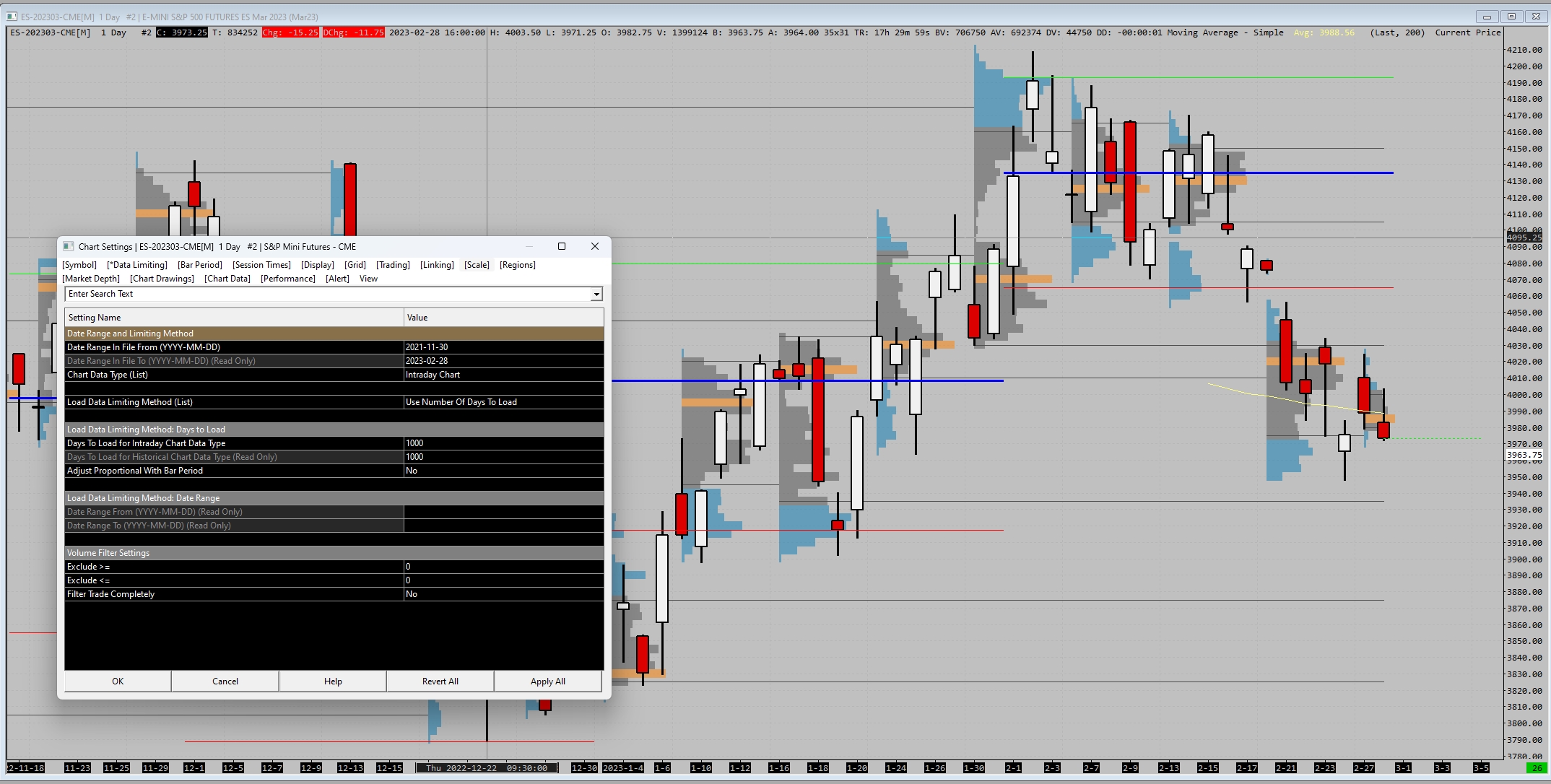

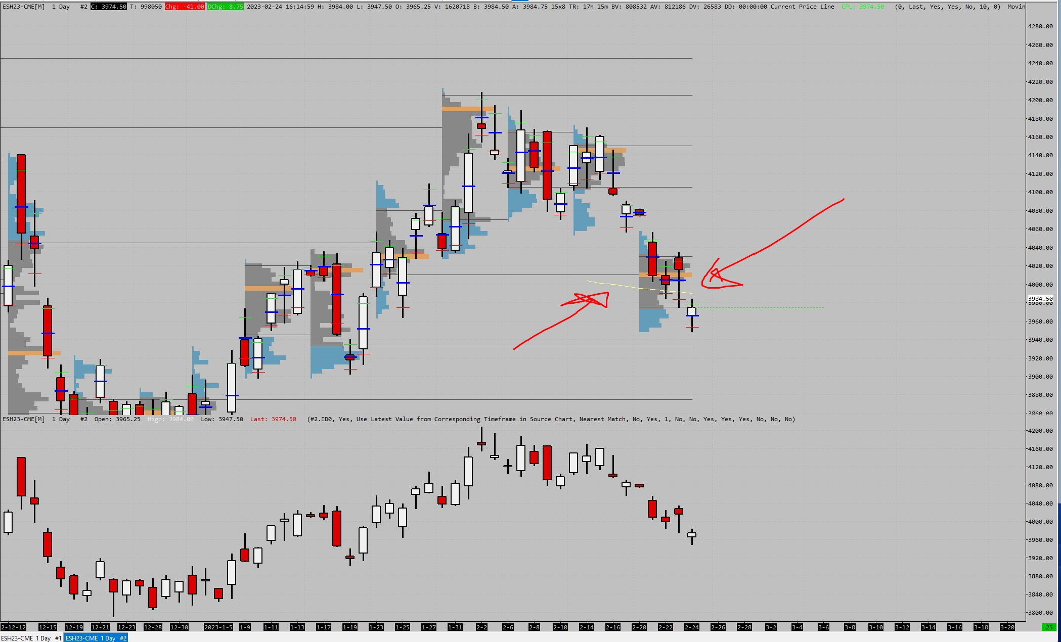

My question is very simple. The 200sma is not showing up in my daily chart. I already checked all setting and read all posts here.
Never recommend any friend to this platform. I'm watching to see if my post gets deleted. This problem is unexisted on other charting platform. Attached is the screenshot and my chart.
Thank you,
attachmentDaily.Cht - Attached On 2023-03-01 00:19:33 UTC - Size: 9.02 KB - 308 views
imageScreenshot_3.jpg / V - Attached On 2023-03-01 00:19:47 UTC - Size: 763.7 KB - 168 views

I already know that. I have over 1000 days. Picture attached.
imageScreenshot_4.jpg / V - Attached On 2023-03-01 01:44:26 UTC - Size: 884.54 KB - 171 views

Sawtooth - Posts: 4361
Do this:
1. Set the Chart >> Chart Settings >> Data Limiting tab >> Days to Load... to 500
2. Set the Chart >> Chart Settings >> Symbol tab >> Continuous Contract >> Date Rule Rollover
3. Hide all studies except the 200 SMA.
4. Add the Bar Numbering study, and set 'Do Not Reset At Start Of New Day' to Yes.
You can now visually see that the 200 SMA starts its line at bar number 200.
